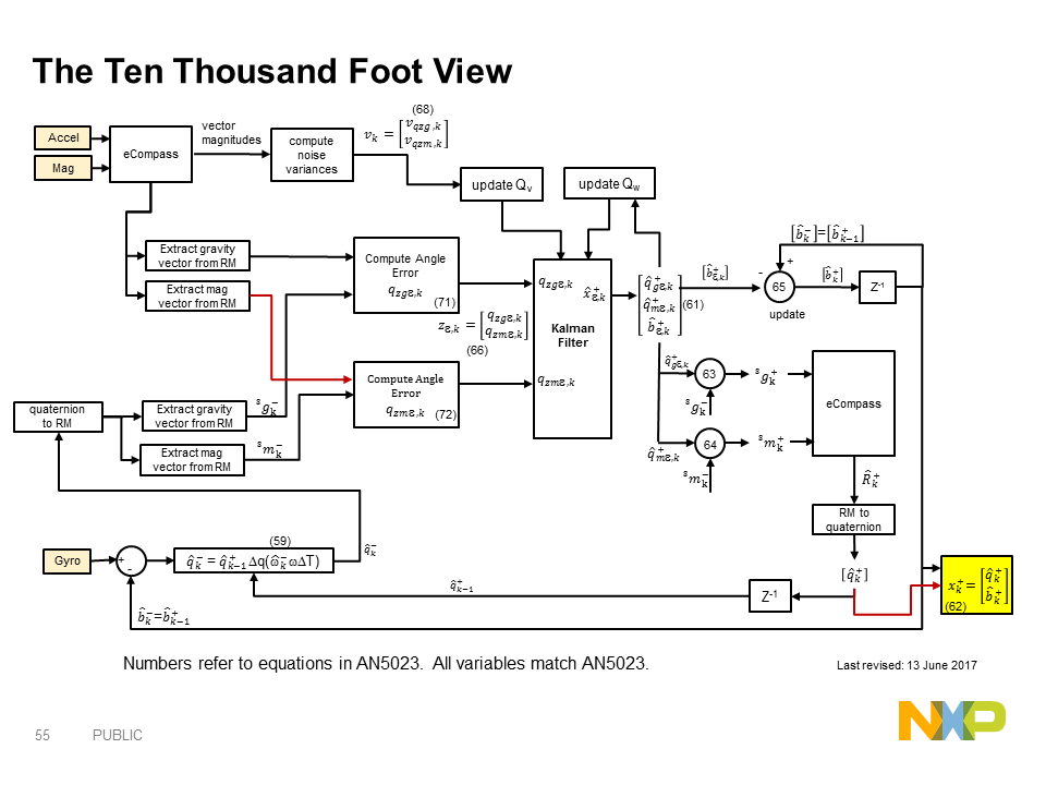

michaelestanley
Jonathan,
You're going about it the right way.  Decreasing FQVY_6DOF_GY_KALMAN will put more emphasis on the gyro.  Increasing FQVG_6DOF_GY_KALMAN will de-emphasize the accelerometer.  I don't think that playing with the min/max gyro offset parameters will help.
Basically, we treat linear acceleration as noise in the accelerometer output, and it's the gyro's job to help smooth that out.   The 6-axis Kalman filter you are using is a subset of our 9-axis, which I recently took the time to diagram:
One knob not listed in the documentation is the box labelled "compute noise variances".  It is used to dynamically tinker with the noise values used in the Kalman filter.  You might try adjusting that.  Look for "fQvGQa = 3.0F * ftmp * ftmp;" inside fRun_6DOF_GY_KALMAN() inside fusion.c.  Try adjusting that 3.0F number up and see if it helps.
To answer your second question, it is a challenging problem.  We originally designed the fusion library specifically targeting hand held devices.  As you noted, it works pretty well there.  But when you have sustained accelerations (linear or angular), some of the simplifying assumptions in the design are broken.  That's what causes the effects you noticed.  To fully fix those, we would need to redesign the filter to take the more complicated automotive dynamics into account, and we've not done that to date.
Mike

joncox
Hi Mike, thanks a lot for the very informative diagram and discussion.
What about playing with fZErr or decoupling fMaxGyroOffsetChange from FQWB_6DOF_GY_KALMAN?
My thinking is that the 3DOF accelerometer gravity vector is being used to "correct" the gyro-based orientation too rapidly. Therefore, I want to limit the rate at which the gravity vector can influence the orientation (trust gyro more). One direct way to do this could be to limit the value of fZErr. Similarly, if I really trust my gyro, I can also more directly limit fMaxGyroOffsetChange, and any associated corrections to fbPl.
The intuition here is that I really only want the gravity vector to very slowly correct the orientation (e.g. over a minute or more). However, if I try to accomplish this by monkeying with variance estimates and so forth, it seems like it can tend to influence other, coupled factors.

michaelestanley
Jonathan,
I would not mess with the max gyro offset parameters.  They only kick in if needed, and since you are precalibrating your gyro, they shouldn't be affecting things.  Similarly, don't mess with fZerr.  The right way to do that is by tweaking the covariance matrix, which is what the parameters in the prior messages do.  By increasing the accelerometer variance numbers, you effectively limit the acceleration effect in fZErr.
