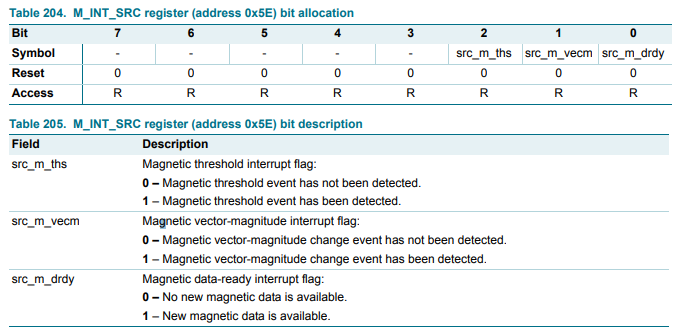

intrudert
What about directing both interrupts to the INT0 ?
1,582 Views
TomasVaverka
You can use the same INTx pin for both events. Then you will have to go to read the M_INT_SRC register (0x5E) to know which event caused the interrupt.
