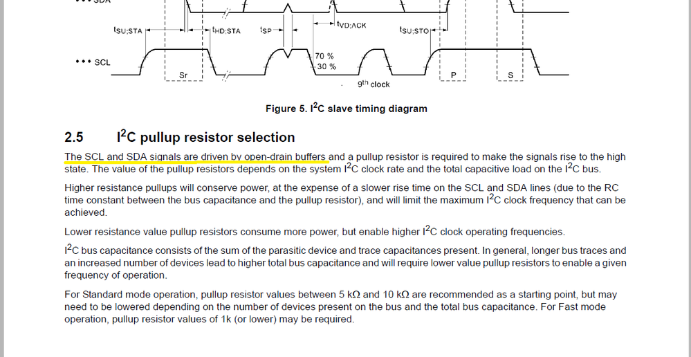

Hello everyone,
referring to I2C of MAG3110 reads:
The SCL and SDA signals are driven by open-drain buffers ...
How do you handle this open-drain ??
Someone can explain it to me?

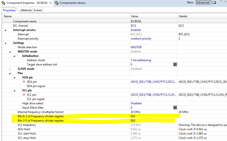

TomasVaverka
Hi Niki,
Referring to the K10 RM, in the Section 44.3.2 I2C Frequency Divider register (I2Cx_F), the I2Cx_F register has two fields:
- MULT --> This one configures the divider factor of the bus clock. Leaving this MULT = 0b00, the internal frequency = bus clock.
- ICR --> This value indicates the value of the SCL divider. You can check the SCL values corresponding to the ICR value in the Section 44.4.1.10 I2C Divider and Hold Values.
The equation to determinate the I2C baud rate is:
I2C baud rate = bus speed (Hz) / (mul × SCL divider)
Here is an example to set the SCL frequency to e.g. 100 kHz:
bus speed (Hz) = 48 MHz = 48 000 000 Hz
mul = 1
SCL divider = 480 (ICR = 0x27, check the table 44.41)
Applying the values in the equation:
48 000 000 / (1 * 480) = 100 000 Hz = 100 kHz
I hope this information can help you. If not, please ask our Kinetis experts.

TomasVaverka
Hi Niki,
I am not really sure what you want to know. Could you please rephrase your question or provide more details?
The MAG3110FC is compliant with NXP I2C specification (UM10204) for both Standard and Fast modes. It is an open-drain communication standard requiring pull-up resistors connected from the I2C lines to the supply to enable communication as shown in Figure 4 of the MAG3110FC datasheet. The pull-up resistors pull the line high when it is not driven low by the open-drain interface.
I hope it helps.
Tomas

Changing the subject, I have to connect to a MK10DN512ZVLL10.
I have some doubt, but now the main one is the definition of the I2C register Frequenzy Divider register (I2Cx_F).
Bus Clock default is 48 MHz. This is the bus speed?
How do I define correctly the other parameters?

anthonyduhamel
Hello Niki,
No it isn't the bus speed. There are prescalers to divide the clock speed from Bus clock to I²C clock (MAG3110 accepts I²C speed up to 400kHz) .
For example if you're using Processor Expert you can change the bus frequency by setting the I²C divider registers.
Anthony
