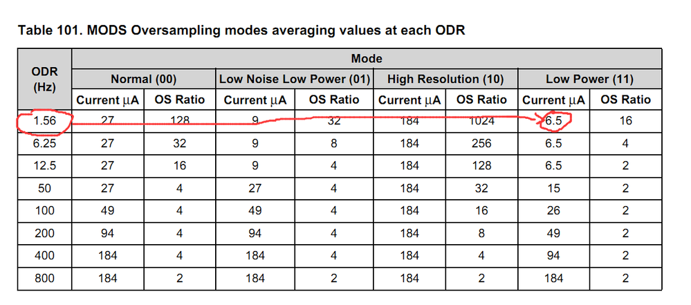

    I have some problem about MMA8652 . I set the ODR=1.56(CTRL_REG1=0x38) , and work in low power mode(CTRL_REG2=0x1b) . It's current should be 6.5 uA.
   But I read the current is 170 uA with digital ammeter . Why?

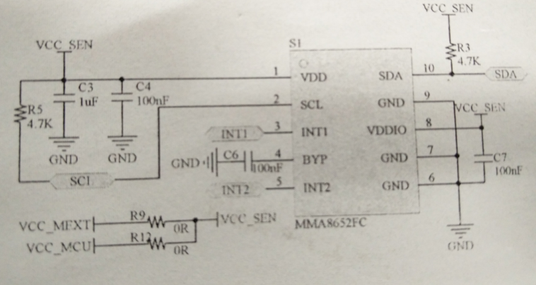

And my Schematic like that
my code is
IIC_write(CTRL_REG1,0x38);              //ODR = 1.56Hz, standby
IIC_write(XYZ_DATA_CFG_REG,0x02);       //+/-8g
IIC_write(CTRL_REG2,0x1b);              //Low Power
  IIC_write(PULSE_CFG_REG, 0x15);         //Enable X, Y and Z Single Pulse
  IIC_write(PULSE_THSX_REG, 0x78);        //Set X Threshold to 7.56g
  IIC_write(PULSE_THSY_REG, 0x78);        //Set Y Threshold to 7.56g
  IIC_write(PULSE_THSZ_REG, 0x78);        //Set Z Threshold to 7.56g
  IIC_write(PULSE_TMLT_REG, 0x28);        //Set Time Limit for Tap Detection to 25 ms
  IIC_write(PULSE_LTCY_REG, 0x28);        //Set Latency Time to 50 ms
  IIC_write(CTRL_REG4, 0x08);             //Pulse detection interrupt enabled
  IIC_write(CTRL_REG5, 0x08);             //Route INT1 to system interrupt
  data = IIC_read(CTRL_REG1);   //Active Mode
  data |= 0x01;
  IIC_write(CTRL_REG1, data);

Hi Jun,
How are you measuring this current consumption? Are not there other devices drawing current as well?
Also be aware that the current consumption stated in the datasheet applies for VDD=2.5V and has been measured with an amperemeter between 2.5V voltage rail and VDD input only.
Tomas

Hi Tomas
    Thank you for you reply !
     I already know the reason . Because the  MCU's IIC isn't working , so the sensor's register use default value .
     This is my fault !
     Thanks again !
