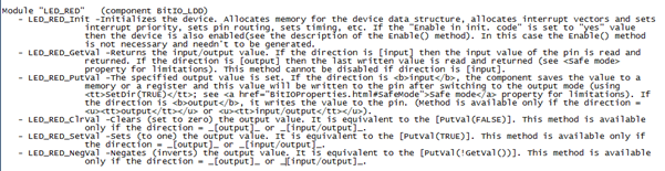

I'm starting to use the SFL with KDS3.0 and I didn't find a documentation about the components, like LED_RED. For example, if I want to turn the led red on, I think need to use LED_RED_SetVal, but I don't know how to use the arguments.

Anderson,
Look at mqx_tasks.c, which toggles LEDs.  Examples include:
// switch the red LED on (line low sets LED on)
LED_RED_ClrVal(NULL);
LED_GREEN_SetVal(NULL);
LED_BLUE_SetVal(NULL);
If you try to set them elsewhere, you probably want to remove them from their current positions.

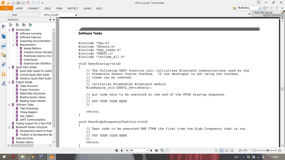

michaelestanley
Anderson,
We didn't ship any documentation under the CodeWarrior and KDS projects in the fusion kit.  Devan may be refering to documentation created via Processor Expert.
Our "human written" documentation is all in the upper "docs" directory.  The best one to start with is docs/XSFLK_UG.pdf, which is the user guide.
Mike

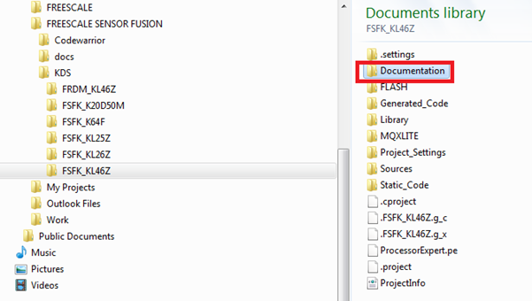

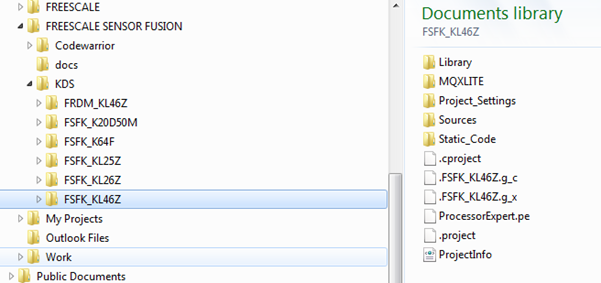

Deejay
Hi Anderson,
Mike is correct. Thanks Mike.
Yes the folder i was referring to was generated by the Processor Expert. You need to build the sample project to get this documentation folder.
See below for example... before and after directory structures under the sample project. FSFk-KL46Z.
Directory folders before building the project
Directory folders after building the project

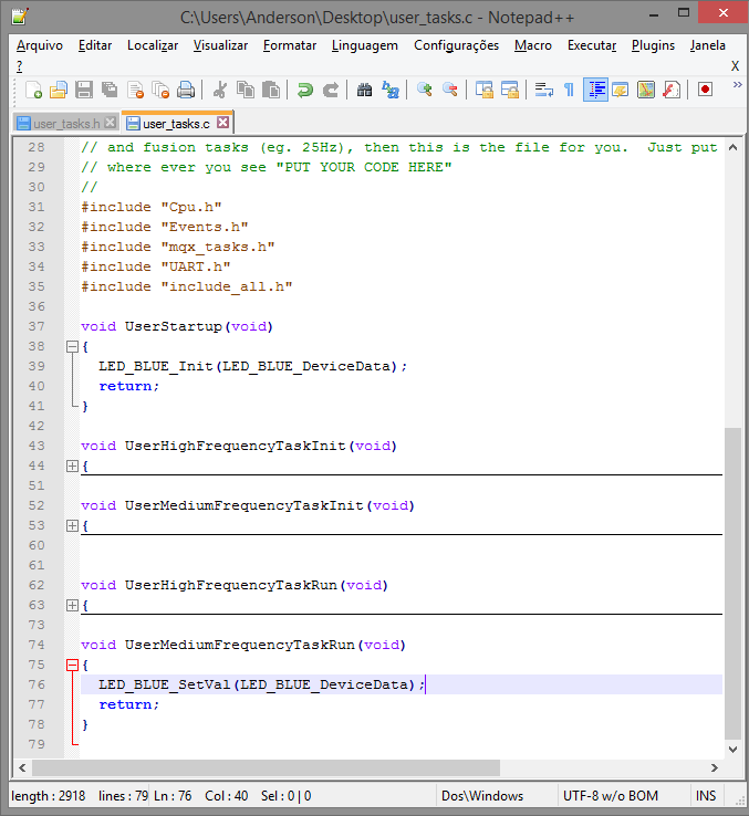

My problem is, I'm new in SFL, and I don't know how to use the user_task to write my application using the SFL. By the documents I need to change the user_task.c, putting my code there.
But, when I remove the codes and put anything like,  from example, nothing happens.

michaelestanley
Anderson,
Mike
