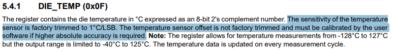

As for the temperature measurement, please keep in mind that the temperature output is not trimmed for offset so the readings will be off. You can correct the offset in software. Sensitivity of 1°C/LSB is OK.

As described in the datasheet, the temperature output is not trimmed for offset. You can correct the offset in software. Sensitivity of 1°C/LSB is OK.

I found the problem. Its not tha value ittself but the way I was representing it .My old code worked fine because the value reported by MAG3110FCR at room temperature was 10 , so an offset of +12/13 was ok. But I declared the value then as in int in my C code. As stated in the data sheet it's an 8-bit 2's complement so the value ranges from -128 to 127. By declaring the value as an int8_t and adding the corresponding offset it fixes the problem.
