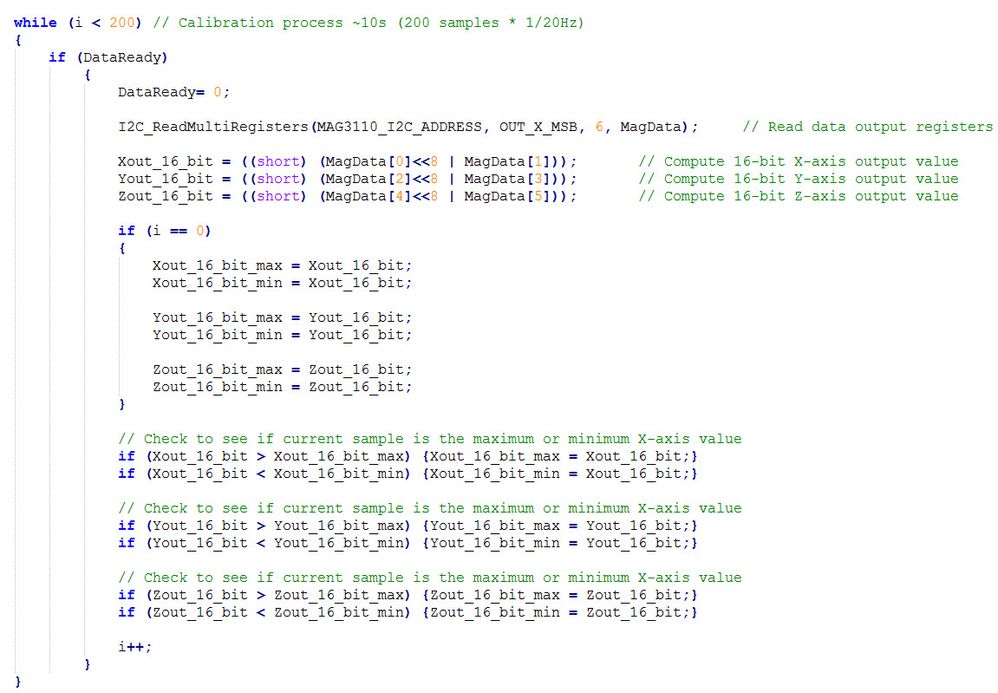

I'm Using the FXTH871xD TPMS Sensor for my development, Now I need to measure the X & Z acceleration and trying to find the X Acceleration Maximum and Minimum points to Send the RF Data.
But I'm not facing some algorithm implementation for finding Max & Min Points.
Wheel is rotating at 100RPM, XZ Acceleration "TPMS_READ_DYNAMIC_ACCEL_X" & "TPMS_READ_DYNAMIC_ACCEL_Z" Called every 100ms.
Please refer my source code for finding MAX & MIN.

Please let me know if anything missed in my source and if any other way of algorithm use to find.
Please anyone help me to resolve this problems

david_diaz
Thank you for writing.
I would like to recommend the procedure that I implemented at a sample project for the MAG3110.
Please review the code below, I hope algorithm gives you an idea:
After the I take 200 samples, now I have the max and min values for the variables above.
Please let me know if I misunderstood your question.
David

sakthivelkuland
Thanks for your response with an example.
I have got an idea by looking at your code. My intention to implement the algorithm to find the Maximum and Minimum Position of X Acceleration when a wheel is rotating.
If found the Maximum and Minimum position then I have to transmit the RD data to Control Board for auto-location.
I have some issue when I'm using  Inbuild Sensor Firmware routine to measure the DYNAMIC ACCELERATION function.
