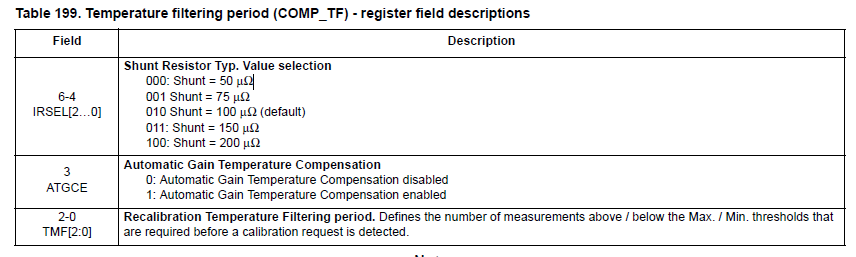

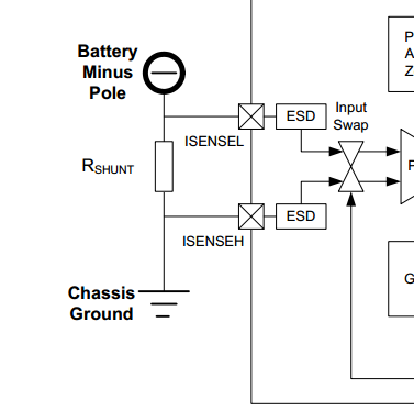

What is the value for you shunt resistor? In the picture you sent me I see you connected one between ISENSEH and ISENSEL. Just as is shown in this diagram:
I'm asking you because there is one register you need to configure in order to make proper current calculations. In the Datasheet for MM9Z1_638 in Table 199: Temperature filtering period (COMP_TF) - register field descriptions, you will find a register named IRSEL, this the register you need to configure according the value of you shunt resistor, because the current calculations are made by measuring the voltage drop VDROP over the external shunt resistor (connected to ISENSEH and ISENSEL) and the value of IRSEL.

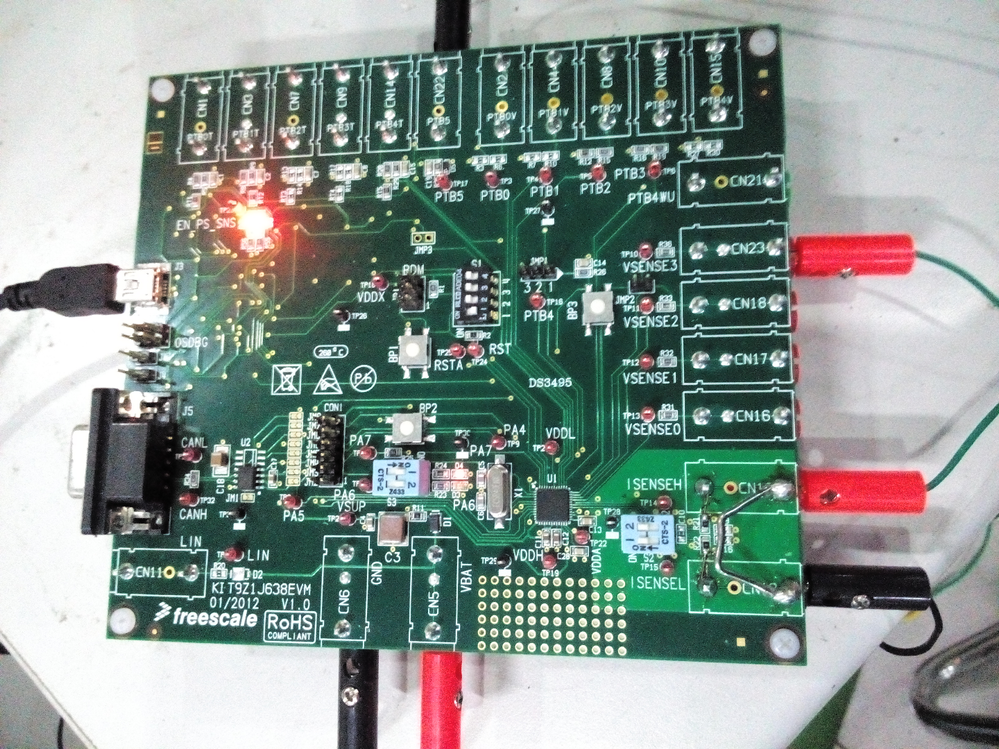

Hello Dawei,

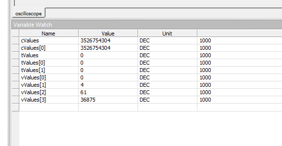

The connection you used in order to measure current seems to be correct, however  I do see that you included in your FreeMaster project the variables cValues, tValues and Vvalues. Those variables is the data for the initialization. I will suggest to declare variables TSensor[tListEntries], VSensor[vListEntries], CSensor[cListEntries], as global variables and use those variables instead, because the sensor values are stored there. Also, don't forget that you need to explicitly tell FreeMaster which is the type and range of the variable you are going to be monitoring, so it can show a proper representation of the variable.

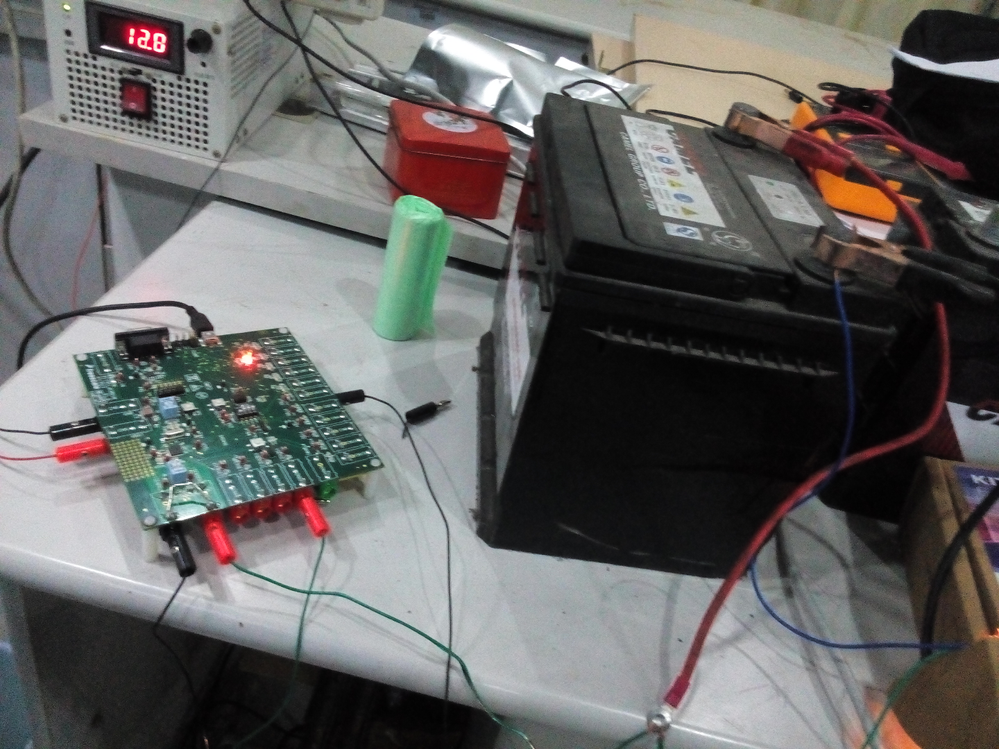

Dear Dario Arias,
thank you your response ,I am using KT9Z1638 board and SCI demo.
now I have already connected the freemaster with the board ,but I can't read the cuurrent voltage and temperature correctly,The connection as follows
the red connector connects battery +; the black one connects battery -;

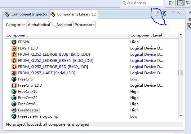

dws
Hi Dario,
Precondition, I use the KT9Z1638 board and code warrior 10.6
I want to add Freemaster to the Demo project of SCI
I just wandered  why I can not add the Freemaster. this is my problem with nothing of the code .

darioarias
Hi Dawei,
Yes, it is possible to scope through FreeMaster with our demo software, but it is different than  using the serial port, because OSBDM has some limitations. Everything is deeply explained in this tutorial
Tutorial: FreeMASTER Visualization and Run-Time Debugging
It was done by Erich Styger, an expert in Freescale’s MCUs. You can take a look on the topic added by Chris Escalante, where they talk about OSBDM and the KIT9Z1J638EVM
