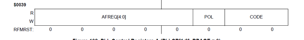

i  am using the fxth87e,how to change rf data encoding to Manchester in data buffer mode? is only change the code part in register?pastedImage_1.png

To change to Manchester encoding in the RF data buffer mode, the CODE[1:0] control bits need to be both clear “00”. You can check the section 15.1.1 from the Reference Manual FXTH87ERM

i have try it, it works good!thanks!
