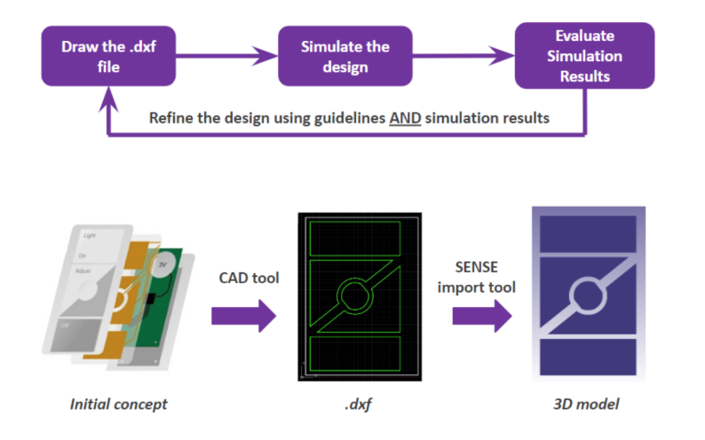

In this use case, we will optimize a touch remote light switch. Traditionally, such a device would feature mechanical components. However, we'll show you how easy it is to design a capacitive- based device, if you have the proper tools.
To refine the design, we’ll use a combination of simulation and guidelines.
Real-life use case: Optimizing a touch remote light-switch through simulation
We proceed to draw the initial design of the model, which you can see above. This rough design has the following specs:
  • Button with sharp edges and 2mm clearance
  • 2 layer pcb with cover glass (50x70mm)
  • No traces, as we’ll add them later
