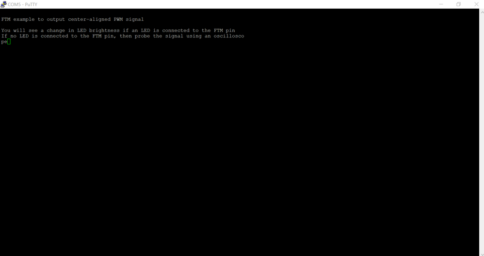

   I'm using sensors in the board FRDM-K66F to obtain some data such as acceleration, and view these data through the software PuTTY. I wonder how I can extrct and save these data so that I could analyse these data by using other tools?

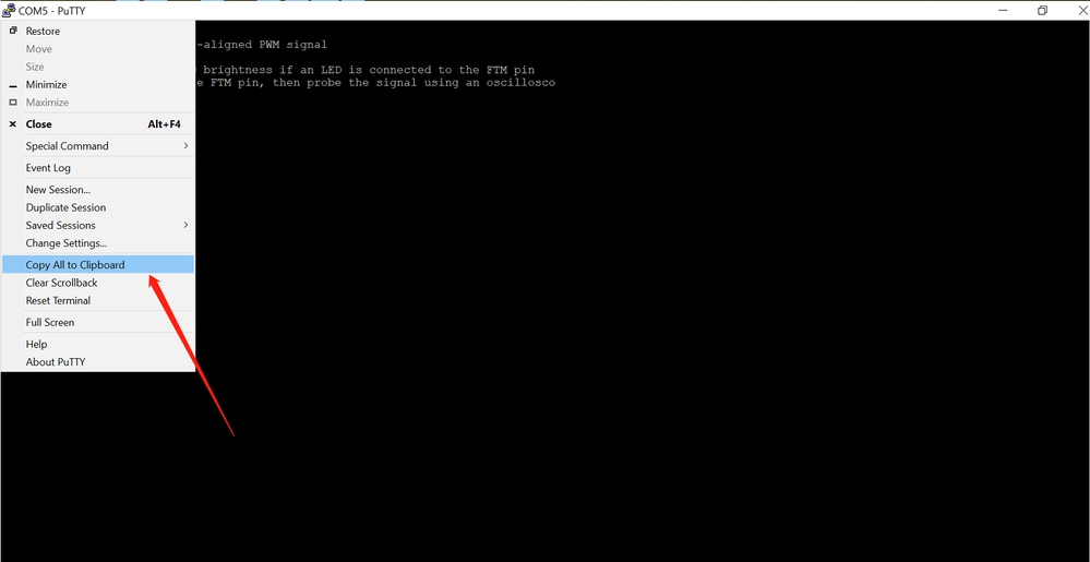

1.You can save data via menu->copy all to clipboard , and the paste to a text file.
2.There are some software like mobaxterm and some others ,they contain the function to save data.
