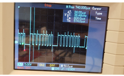

I tried the code you suggested and I managed to see the output I wanted from CLK, MOSI, SS pins. I can see the values that I sent via FXTH on the CC1310 module, but the places of the values I sent after the first value get mixed up.I've experienced this before because it was doing when the correct communication speed was not available.I could not find the communication speed of FXTH anywhere but when I look through the oscilloscope, it turns out to be 38.46kHz.
How can I find the communication speed of FXTH?

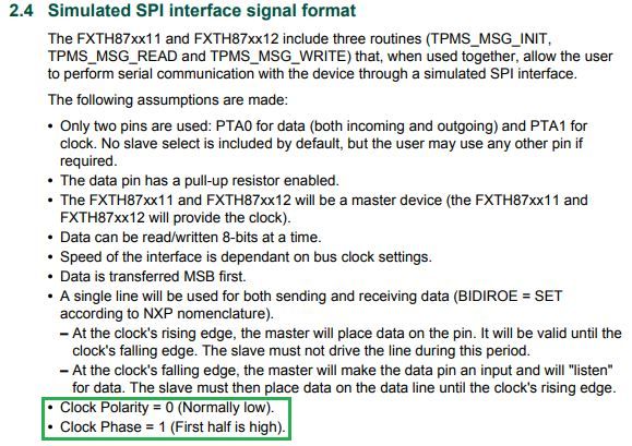

We do not specify the baud rate of the SPI communication as this does not need to be configured on the slave side.
I think you did not configure the CPHA correctly. It should be CPHA=1 and it looks like you configured CPHA=0.
Information on the simulated SPI interface can be found in the firmware user guide:
I hope this helps.

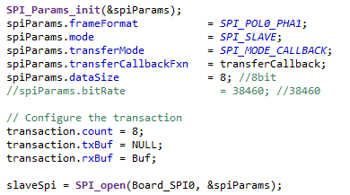

Hi Tomas,
Considering what you said, I changed it to CPHA = 1 but the problem still persists.
I use 4 pin SPI structure as a structure.
The value I send is getting mixed up as seen in the pictures below.
FXTH Value:

Values to CC1310
Every once in a while, the value I send is coming right.
Current CC1310 Settings
