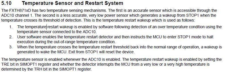

Hi, Is there built in Temperature sensor in FXTH8715xx series? As i found some discrepancies in the document and device descriptions on the web.

1. The data sheet of FXTH871x7 device (rev 0.3 , 02/2015) says the sensor has built in Temperature sensor.
2. The device family description in the link: FXTH8715|TPMS|Pressure Sensor|NXP  misses to mention about temperature sensor. However the block diagram of the device shows temperature sensor.
Please clarify. Thanks in advance!

Hello Prashant,
Yes, the FXTH8715xx series does have a temperature sensor.
I am not really sure why it has been omitted in the description. Let me check with our product line and web team if it can be added.
