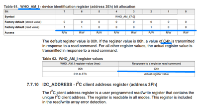

JozefKozon
Hi Francois,
could you please provide reading from the WHO_AM_I register? In a scope from an oscilloscope or from a logic analyzer? When you read the WHO_AM_I register, you should read the 0xC4 value.

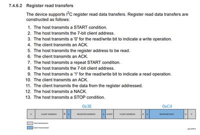

francoisdugue
Hi Joseph,
Yes you're right the return is xC4.
I'm using Logic analyzer from Saleae, inc.
I can only share to you the logs because of Network policy...
The following logs show the execution of
(void)fxps7xxx_init();
(void)fxps7xxx_get_pressure_temperature(&f32Pressure, &u8Temperature);
And as you can see, it return 0xC4.
write to 0x60 ack data: 0x3E
read to 0x60 ack data: 0xC4
write to 0x60 ack data: 0x14 0xC0
write to 0x60 ack data: 0x15
read to 0x60 ack data: 0xC0
write to 0x60 ack data: 0xC4
read to 0x60 ack data: 0x0C 0x40
write to 0x60 ack data: 0x62
read to 0x60 ack data: 0xA3 0x76
write to 0x60 ack data: 0x0E
read to 0x60 ack data: 0x5E

JozefKozon
Hi Francois,
thank you for your answer. Great, so you are receiving correct value from the WHO_AM_I register.
