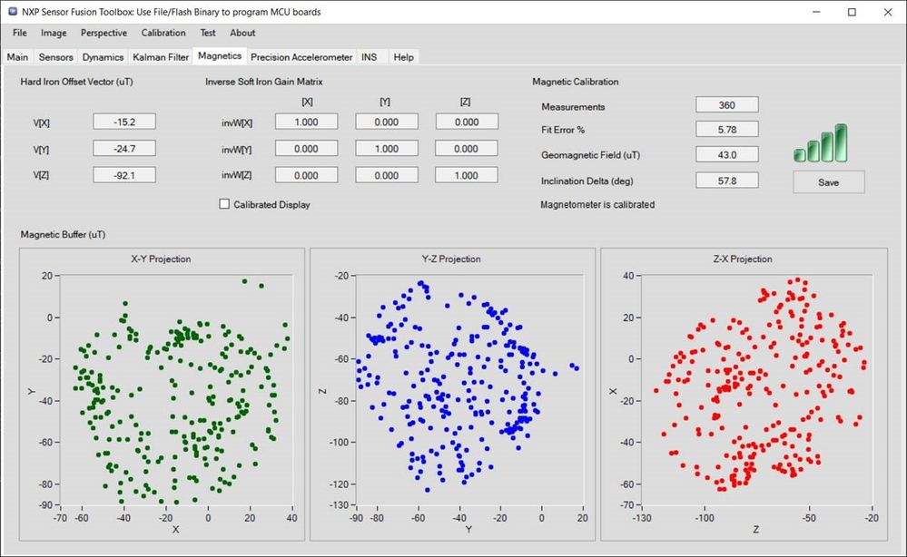

I tried following Sensor Fusion execution with FRDM-K64F-AGM01 using both the FXOS8700 and FXAS21002:
1. Magnetic calibration with normal test environment:

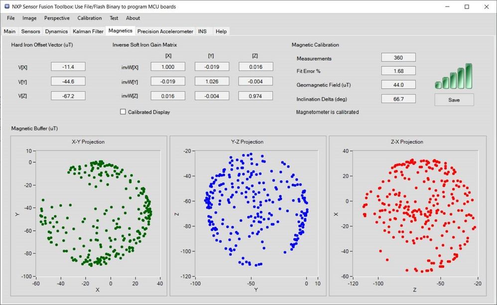

2. Magnetic calibration with aluminum material on the board (stacked using tape to the board):
Of course there is little variation in the magnetic buffer projections/distributions and slight variation in the fit error %, but I don’t see much variation that show visible impact. These minor variation seen can be observed in multiple run, similar test environments.

I see the data of an uncalibrated MagneticBuffer structure, in my message is attached the fBc data of the MagSensor structure.
if it’s easy for you, could you:
1. add calibrated data (by checking)
2. In the second figure, the soft iron is not calculated.
3. After calibration, rotate 360 degrees and add the result.
