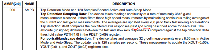

Good afternoon, I am developing an application with the mma7660FC, I have read about the various functions but I do not understand what filters are referred to in this part.
Document: https://www.nxp.com/docs/en/data-sheet/MMA7660FC.pdf

I have the mma7660fc on hand :c , any idea of the filters I mentioned?
