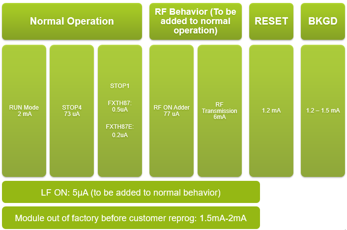

Hello everyone!
   I am debugging the power consumption of the FXTH870911.
   The current minimum current is 98-115μA.
   After calculation, the current power consumption cannot meet the demand.
   I want to know what the minimum operating current of this chip is and how it is implemented.
Thanks in advance!

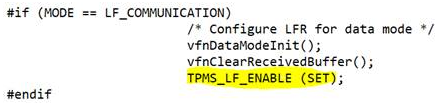

Please see below a typical current consumption at 25°C:
You can find a detailed description of stop modes in the device datasheet.
In the project, the LF block is enabled in STOP1 in case the mode LF_COMMUNICATION is selected.
The selection of the mode is to be done in the file user_configuration.h of the project.
In this file, there is the possibility to select three different modes, one using LF (LF_COMMUNICATION) and two not using LF.
I would recommend to select the mode NO_LF_PWU: with this mode the FXTH wakes up periodically to send RF frames, and between two transmissions it goes to STOP1 with LF disabled. With this mode you should see a power consumption of 500nA between two RF transmissions.
