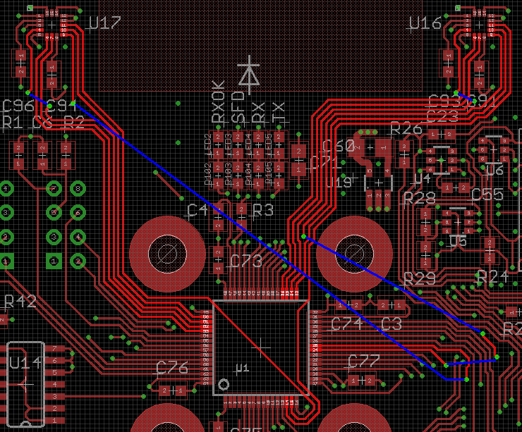

OK, here's where it all starts ...
which leads to this (the blue lines are not the real layout, just made them by hand just now) ...
so the connections are ...

Hmm ... wonder how to insert source code ... guess I have to check out the advanced editor ...

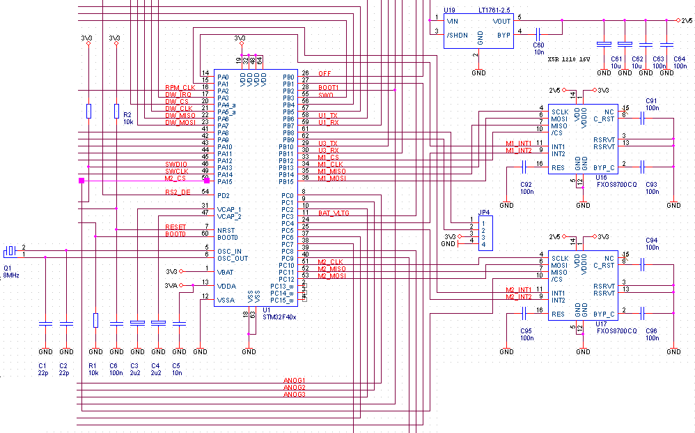

Hi Joerg,
Regarding your schematic, I suggest you to connect FXOS8700's RES pin to the ground. Capacitors C92/C95 must be short-cut to ensure a low level on the reset pin.
(You can insert source code by copying it in the classic textbox. Then "Use advanced editor", select you copied code and press ">>" in the toolbox. Click on "Syntax Highlighting -> C++").
I don't know if it will fix SPI issue but try it first!

joergonfreescal
Hi Anthony,
turns out I'm not THAT dumb :-) ... these parts in reality are 0 Ohm "resistors". I now found that I used the second latest version of the schematic above. So that's not the reason, unfortunately. And I already got my hopes up :-) ... I'll post the source as soon as I have it in reasonable shape and tested again.

joergonfreescal
Hello Anthony,
thank you for pointing this out. It's strange ... I have no idea why I put these capacitors there ... checked the docs I used ... no caps anywhere ... :-(.
Either I temporarily confused RST and Crst or I don't know. Really disturbing as I must have checked the schematic a 100 times but that thing was in some kind of a mental blind spot. There must be smarter life forms in the woods :-) ... unbelievable ... OK, thanks again and I'll be back as soon as I know for sure. Have to get rid of all the changes to my software which I made because the correct setup didn't seem to work ... BTW this website changed the capitalization - the nic was supposed to be JoergOnFreescale.

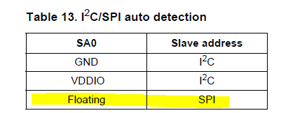

Some questions about your Hardware design: is it a point-to-point communication, or are there multiple slaves on the SPI lines? Did you put the SA0/MISO pin to High-Z (High Impedance ) state to enable SPI communication on FXOS8700 at the device start (for at least 1ms )?
Software side: Can you share with us samples of your code? To be sure the device is working well, read the WHO_AM_I register. If the returned value fits to the expected one SPI communication should be ok.
