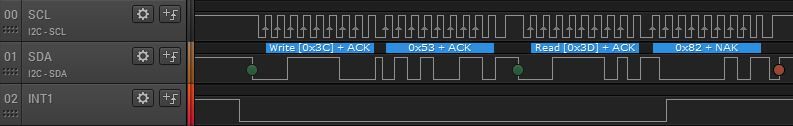

TomasVaverka
Hi Di,
I have just done a simple test using the following settings (without the sleep mode) and it works well as you can see on the picture below.
void FXOS8700CQ_Init (void)
       I2C_WriteRegister(FXOS8700CQ_I2C_ADDRESS, M_THS_X_MSB_REG, 0x00); // Threshold value MSB
       I2C_WriteRegister(FXOS8700CQ_I2C_ADDRESS, M_THS_X_LSB_REG, 0x80); // Threshold value LSB
       I2C_WriteRegister(FXOS8700CQ_I2C_ADDRESS, M_THS_CFG_REG, 0xCB); // Event flag latch enabled, logic OR of enabled axes, only X-axis enabled, threshold interrupt enabled and routed to INT1
       I2C_WriteRegister(FXOS8700CQ_I2C_ADDRESS, M_THS_COUNT_REG, 0x0A); // 100ms at 100Hz ODR and magnetometer mode only
       I2C_WriteRegister(FXOS8700CQ_I2C_ADDRESS, M_CTRL_REG1, 0x1D); // Max OSR, only magnetometer is active
       I2C_WriteRegister(FXOS8700CQ_I2C_ADDRESS, CTRL_REG3, 0x00); // Push-pull, active low interrupt
       I2C_WriteRegister(FXOS8700CQ_I2C_ADDRESS, CTRL_REG1, 0x19); // ODR = 100Hz, Active mode
void PORTD_IRQHandler()
       PORTD_PCR4 |= PORT_PCR_ISF_MASK; // Clear the interrupt flag
       M_Ths_Source = I2C_ReadRegister(FXOS8700CQ_I2C_ADDRESS, M_THS_SRC_REG); // Read the M_THS_SRC register to clear the SRC_M_THS flag in the M_INT_SRC register and deassert the INT1 pin
Can you please try to reproduce it?
Meanwhile I will try to implement the sleep mode.
Tomas

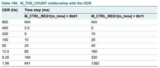

TomasVaverka
Hi Di,
The time step used by the debounce counter depends on the chosen ODR and m_hms[1:0] bits.
So the only way to reduce the time step is to increase the ODR and eventually use only the magnetometer (m_hms[1:0] = 0b01).
Tomas
