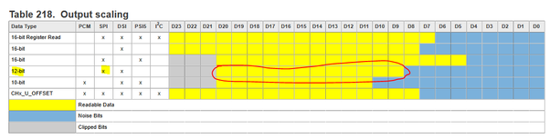

1. Two-axis sensor data acquisition:
In the acquisition of two-axis data, I used the default 12bit data bytes,8bit check, using SPI communication, according to the illustration, 32-bit data packets should remove the following 17-bit data (9bit noise,8bit CRC), but the actual simulation found that I removed the following 12bit, the data is normal. The figure also does not correspond to the following Sensor response format. How should I understand this?

Hi Wenfeng,
1. This question is not clear to me, I would need below clarification:
Are you using register read and sensor data request command for data acquisition?
If you are using sensor data request, the 12-bit provided (highlighted in yellow on the second picture below) is aligned with the red circle in 3rd picture. “Optional SD resolution” bit will all be 0’s in  12-bit resolution configuration.
2. TrimSensitivity is fixed by variant and is 33.0161 LSB/g at 12-bit for medium-g device for other resolution (i.e 10-bit or 16-bit etc.) the TrimSensitivity needs to be scaled at defined in Table 218.
I hope it helps.
BR, Tomas
