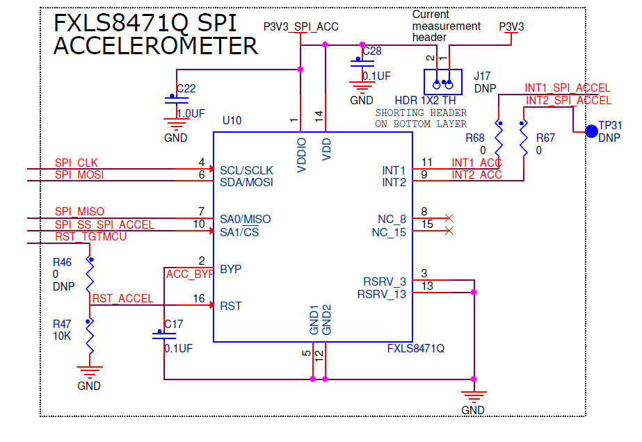

Hello, I'm running into some problems getting the fxls8471q to wake up in spi mode.  I have RST tied to vss.  The SA0 line is going to a pin on the MK10DN512VLL10 which happens to power up as an analog input.  Although it is somewhat floating, there is a weak pull up.  How exactly does the FXLS8471Q determine that pin is floating?  Is it trying to pull up/pull down weakly?  I see INT1 going low for 500nS, but I only see SA0 rising to VDD over a period of 2mS.  Apparently it is waking up up in I2C mode, because I can't read anything from the WHO_AM_I register.

anthonyduhamel
Hello David,
I used the FXL8471Q accelerometer on a FRDM-KL25 board+ MULTIB shield.
If you want to take a look at the schematic, I attached a sample of the hardware below:
If the FXLS8471Q doesn't boot in SPI mode, you can reset the sensor by toggling the RST pin. That's totally normal the INT1 goes to low for 500ns, it indicates that the sensor has successfully complete its reset sequence.
I think your schematic is good, it's probably a software issue.
I suggest you to check your spi communication, can you share your code with us?
The SPI communication with the FXLS8471Q is very specific, did you check the SPI specifications in the datasheet?

davidsherman
Senior Contributor I
Thank you Anthony, as I said, I was able to read the WHO_AM_I register once I corrected the wiring mistake.  The SPI does not appear to be a problem, and apparently the weak pull-up on the MK10 at power up isn't keeping it from waking up in SPI mode.  My only question is how strong does the pull-up have to be before it wakes up in I2C mode.  More specifically, if I need to tie RST to an I/O line so the MK10 can wake up enough to configure the MISO pin so the pull-up is disabled before toggling the reset, it would be good to know.

davidsherman
Thank you, Tomas.  It turns out the problem was an error in the board layout, so the MISO/MOSI lines were backward to the part (oops!).  Now that I've got them wired properly, I see MISO start to rise, then it's pulled down to about halfway between VDD and VSS for 5mS.  It must be waking up in SPI after all, because I can read the WHO_AM_I register now.  I am still curious how much of a pull-up or pull-down it can tolerate before it determines that it's not floating.
