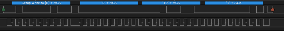

I have been struggeling to get the gyrometer ( a fxas21002c) on the nxp 9DoF precision module  work.
For a company project I need to read the measument values of the gyro, using a STM32F446RE via an I2C bus. I wrote a GyroInit() function to initialize the sensor, but if I read the GYRO_REGISTER_CTRL_REG1 register after initilization, the entire register is still 0. So initialization seems to go wrong, I hooked up an osciloscoop and the osciloscoop shows that the STM writes the init data.
For the past few days I have been trying to figure out why the register never gets set, help would be appreciated.

REG1 read plot:

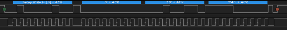

Initialisation sequence:
Reset:
Set REG1 (control register):
Set Active:
The WHO_AM_I read looks different than yours, but it returns the correct value.
Can you see a mistake?

It seems like your write operation is incorrect. The correct format looks like this:
So if you want to write 0x03 to the CTRL_REG1 register (0x13), you need to (when SA0 = 0):
1. Send a start sequence
2. Send 0x40      // FXAS21002 slave address with the R/W bit low or 0x20 << 1
3. Send 0x13      // Address of the CTRL_REG1 register
4. Send 0x03      // Data to be written to the CTRL_REG1 register
5. Send a stop sequence
Hope it helps!
Tomas

mkruithof
Dear Tomas,
At the moment I use a function STM provided to do exactly what you say, I do the following:
    uint8_t tempData = 0x03;
    HAL_I2C_Mem_Write(&hi2c1, (0x20 << 1), 0x13, 1, &tempData, 1, 100);
Function definition of HAL_I2C_MEM_WRITE:
HAL_StatusTypeDef HAL_I2C_Mem_Write(I2C_HandleTypeDef *hi2c, uint16_t DevAddress, uint16_t MemAddress, uint16_t MemAddSize, uint8_t *pData, uint16_t Size, uint32_t Timeout)
The plot from this code is what is shown in picture 2 (set REG1) of my reaction.
But this does not seem to work.
