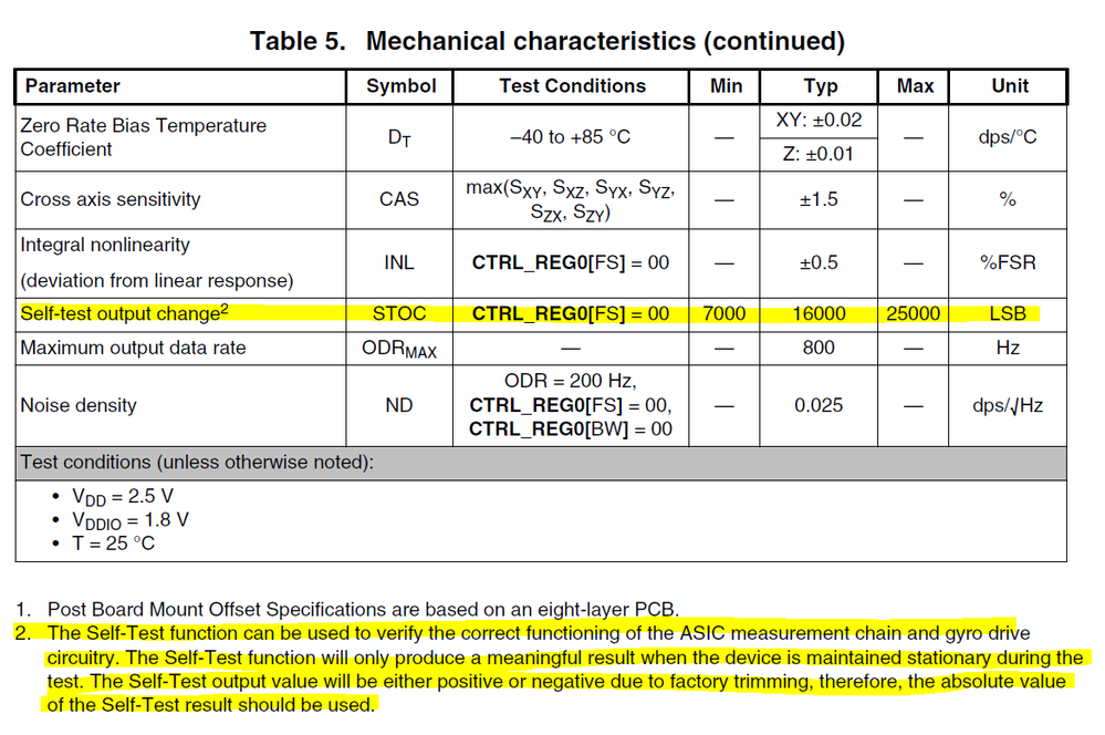

Also I have question regarding to self-test process. Firstly I read some samples from gyro then I set ST bit in CTRL_REG1 and again read  from OUT_x_xxx?
This reading gives me const value of 8191 on all axis.

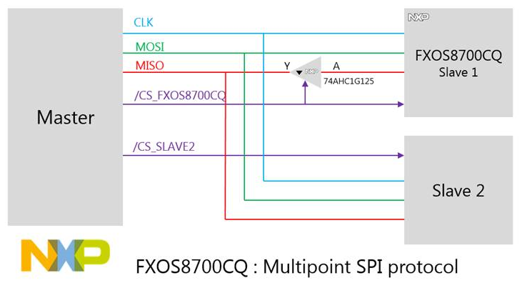

I meant acc+mag (I forgot to mention the model in previous post) FXOS700CQ which can't be connected to any other SPI device because it doesn't tri-state MISO pin.
3,306 Views
anthonyduhamel
This problem can be easily fixed  with a tri-state buffer.
For example:

It's a very good gryo but there is a one little catch. You can't read from both gyro and acc using SPI Smiley Sad I was wondering why everyone use I2C rather than SPI :smileygrin:

It's a very good gryo but there is a one little catch. You can't read from both gyro and acc using SPI  I was wondering why everyone use I2C rather than SPI
Yes you can use the same SPI bus for serveral sensors. That's why there is a chip select pin (/CS).

For the SelfTest
Please take a look at the table below. The value you have looks to be okay.
Anthony

Thanks for info about Self-Test. I wasn't sure if it should be constant value.

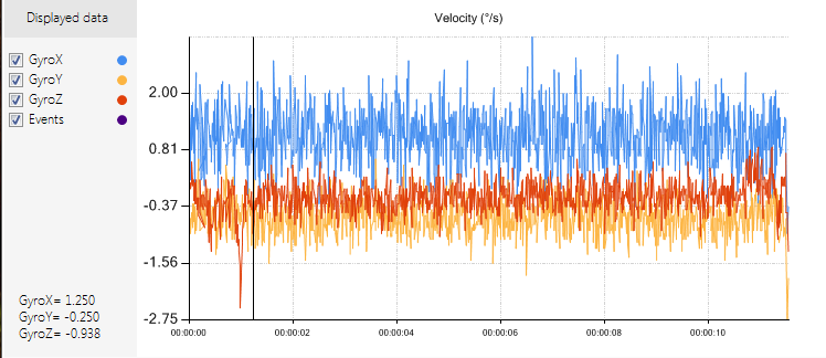

I understood your issue. Can you share your source code with me? It's really hard to know what is not okay. Maybe the sensor is not well configured. You can all try to extend the gyroscope range up to 2000dps.
I did a test with our RD-KL25-AGMP01 Datalogger board, recording data at 100Hz. I got pretty good results with the trapezoidal integration. I attached an excel spreadsheet if you want to look at the accuracy and formulas.
Yes Karol, it should change each time. Take a look at the plots below:
                                             With Self-Test                                                                                                                                                      Without Self-Test
