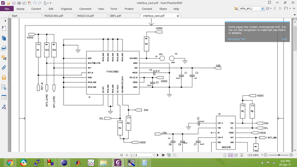

The layout design I have made houses one MAG3110(Magnetometer), one FXAS21002C(gyroscope) and 3 temperature sensors(STCN75) all having  inbuilt I2C interface. Im using Smartfusion2 based Emcrafts development board which is configured to have I2C communication using the IP cores available with Smartfusion2 Libero IDE.

  • I assume it is not a coding issue, because you can communicate with the MAG3110 but I want to verify if the FXAS21002 replies by acknowledge bit during all the I²C query.pastedImage_1.png
  • Can you share your schematic to take a look at? I'm wondering if you connected the RST_B pin to the supply.

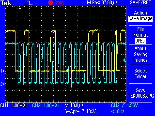

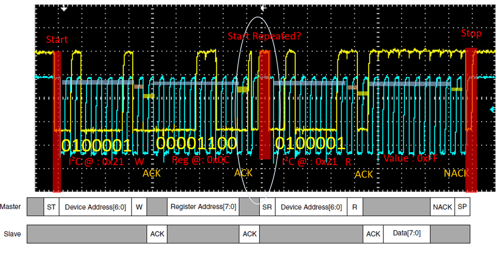

emoderahul
Write command with register address selected as 0x0c
Read command and in response getting 0xff (expected Device Id: 0xD7) from the device register 0x0c.
The whole plot for the read operation for getting the Device ID:0x07.

anthonyduhamel
Hi Rahul,
Thanks for the material.
  • Regarding your screenshot, can you check the SR condition (Start Repeated condition)?
I'm not sure to be right, but the small pulse before the SR condition seems strange.
  • The schematic looks good. Just one comment: you don't need several push up resistors for the I²C lines (SDA/SCL). I mean you can use only one for each node, no need to add resistors for each device using the I²C.

emoderahul
1. Even though I'm giving separate independent pull up resistors for each IC, I have wired only one pair for SCL and SDA lines.
2. "I'm not sure to be right, but the small pulse before the SR condition seems strange." For analyzing this, I used a Rasperry Pi board to initiate I2C communication. Here the waveform is clean and there is no small pulse before the SR condition. But the IC is failing to give the desired register content. (including the DEVICE ID).

emoderahul
I have connected the RST_B pin to 3.3V using 47K as recommended in the data sheet.layout.png
