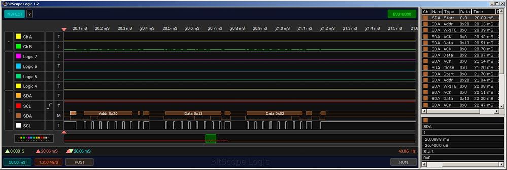

I am using the FRDM-FXS-MULTI-B board to evaluate and prototype a product with a Parallax propellor MCU.
I have the FXOS8700CQ working and responding so the i2c code is solid.
I can read all of the registers on the FXAS21000 gyroscope and the boot complete flag does go to 1 after a hard reset.
The problem I am having is that I can not set the 'Active' or 'Ready' bits in CTRL_REG1. I can set other higher bits in that register but for some reason bits 0 & 1 do not toggle. When I set the ST (self test) bit, the data does not output as described in the cdocumentation.
Help?
Thanks in advance,
Jim-

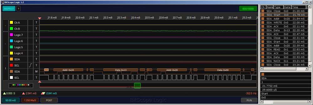

Hi Jim,
It is hard to say where the problem might be, I am able to set both Active and Ready bits individually or simultaneously as you can see on the following screenshots.
Writing 0x03 to the CTRL_REG1 register:
Reading 0x03 from the CTRL_REG1 register:
Could you please post here similar screenshots illustrating both I2C write and read operations with the CTRL_REG1 (0x13) register? It might be also useful to see your source code.

jimmiller
I Can send you logic captures when I get back to lab tomorrow. I'm doubting its the code though, it works for other registers, even the configuration register with the 'active' bit. I can also set low order bits on other registers.
Per your question,  the output does not change when I set the ST bit. I was thinking it can only output data when 'active' but that was an assumption.
I Ordered another FRDM board to compare, it seems like a hardware issue so when the new board arrives I can compare results.

jimmiller
OK, new board arrived and gyro works. Has a bad gyro.

jimmiller
Ok, sent email to Dan, thanks for that.
Below are the logic analyzer captures of the Write and subsequent read of register $13.
