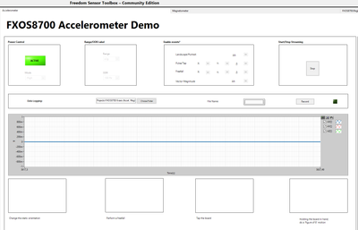

I am new to NXP Sensor Toolbox with FRDM-K22F-AGM01 (with FXAS21002C and FXOS8700CQ).
I have installed the "Freedom Sensor Toolbox" program and connected my sensor kit, and the FXOS8700C Magnetometer demo part is working fine, but FXOS8700C Accelerometer demo screen don’t react to any changes/movement to the sensor (see picture below)
Question: how do I fix the problems ?

Hi Jan,
We have seen this issue in the past and the reason was in local preference and format setting on a computer. Please follow the instructions in the attached file, it should help.
Tomas

Hi Tomas
Thanks ... It is working now.
