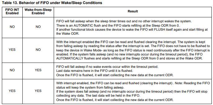

Hi Jean,
I am not sure if I fully understand your use case, but when it comes to the behavior of the FIFO I would refer to the Table 13 of the AN4074.
Tomas

Hi Tomas!
Thanks for your reply! That answers my question!
