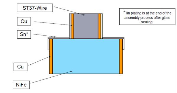

Currently Using KTY83/110 sensors, need to know the material of the leads for attachment purposes.

Hi Brian,
Please see the picture below. The tin thickness is 1-5µm.
Tomas
