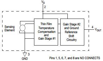

1. MPXA6115AC6U (CASE 482A-01, Small Outline Package):
1 – N/C
2 – Vs
3 – GND
4 – Vout
5 – N/C
6 – N/C
7 – N/C
8 – N/C

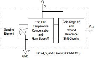

2. MPX5100GP (CASE 867B-04, Unibody Package) and MPX5010DP (CASE 867C-05, Unibody Package):
1 – Vout
2 – GND
3 – Vs
4 – N/C
5 – N/C
6 – N/C
Let me know if you have any other questions.

Hi Jianjun,
You are right that the MPX5010DP is a differential pressure sensor with two input ports, but it is also housed in a Unibody package with the same pinout as the MPX5100GP.
I hope it clarifies your question.

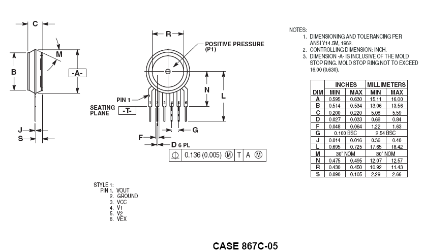

another question,(see the pic below)  the pins V1,V2 is uesed to factory test,we should not conected?
the pins(see the pic below)  +VOUT,-VOUT is differential output?

Hi Jianjun,
Yes. V1, V2 and VEX pins are used for factory trimming and then they are laser cut. We recommend to leave those pins floating/unconnected.
As for your second question, please refer to the Different pin styles in pressure sensors documentation.

       Can you tell me the PACKAGE DIMENSIONS of 5010DP and 5100DP ?
the case 867C DIMENSION and package sketch in 5100DP datasheet seems depict two packages,
