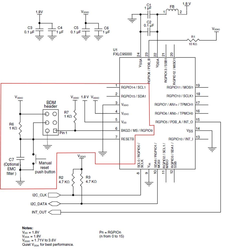

Hello Ilya,
In case you are using your own board, please make sure you have the following configuration in order to program the device:
I hope this information will be useful for you.

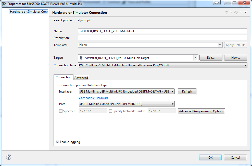

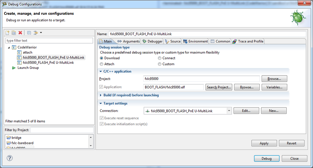

ilya
Hi Jacques,
- it is KITFXLC95000EVM board, not a custom one.
- I constantly get a popup dialog asking to power cycle a board. But this doesn't help I assume a programming adapter can not "catch" a target during POR or something. This started to happen when I programmed a project.
After many unsuccessful connection attempts a chip was re-soldered, it was replaced by fresh one. This worked, I was able to "Attach" with debugger (w/o Flash programming). But when I tried to program my project again, the same issue appeared - no BDM communication.
- Debug configuration:
I tried to attach my s-record but I guess it was a reason why my previous post was rejected.
Thank you for your reply,
