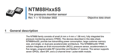

The datasheet says that it works in client-SPI mode. but my application requires to work in slave mode.
Kindly help suggest me if I can use this particular IC NTM88H065ST1 in SPI Slave mode.

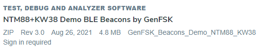

Hi Ankit,
Yes, for an example of sensor data transferred via SPI to a host MCU, you can have a look at the below demo package which contains demo projects and a user guide:
https://www.nxp.com/products/sensors/pressure-sensors/tire-pressure-monitoring-sensors/ntm88-highly-...
Tomas
