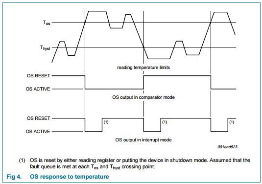

Hi, if I set the Tos to be -20 deg C, will OS be triggered when temp fall below -20 deg C (e.g. -21 deg C)? Or the other way round?

Hi Lee,
Unfortunately it is not possible. The only two modes the thermal watchdog operates are illustrated in Figure 4.
