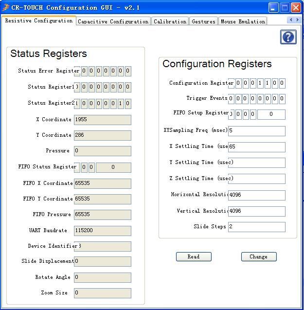

   I start work with CRTOUCH, and found some problem with CRTOCH and 5-wire TP.  I use "Xtrinsic CRTouch Capacitive and Resistive Touch-Sensing Platform Evaluation Board"
The 5-wire TP can work under mouse emulation tab.  And I successed calibration. But when I change to Gestures tab and start test, it shows:
"Multi-touch points NOT calibrated. Please calibrate first at the 'Calibration' tab."
Pls take a look at the following image:
The calibrationg is ok.
But here, it show calibration is not ok.
The data from IC looks ok.
When I use a 4-wire TP, it will work, but 5-wire TP not.
Anybody who met this problem before?
Thanks a lot!

Hi Luo Deqiang
Unfortunately, dual touch gesture recognition is only supported for 4-wire resistive touch and unfortunately there is no other solution that we can offer to work with gesture recognition dual-touch with 5-wire.
Basically, this is not a technical issue, but it is the way the algorithm is implemented for the CRTOUCH, this algorithm consider the impedance distribution of a 4-wire screen (connections, signal polarization) and therefore, the impedance distribution are different for the 5-wire screen panels.
So, unfortunately , it is not possible to detect double touch gesture detection with the 5-wire CRTOUCH, 5-wire CRTOUCH only support single touch detection.
