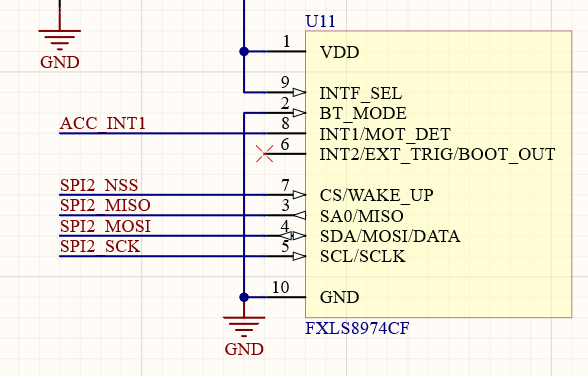

JozefKozon
Dear Adrien,
please check how you have connected the BT_MODE pin. To GND or to VDD?

adrian_chmiel
to GND

JozefKozon
Hi Adrien,
thank you for the confirmation of the BT_MODE pin connection.

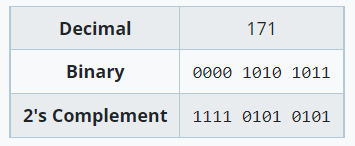

The values in the SDCD_LTHS[11:0] and in the SDCD_UTHS[11:0] should be entered in 2's complement format. Please use this calculator to calculate the values.
For example 171 in decimal, in binary is 0000 1010 1011, however you need to enter 2's complement format, which is 1111 0101 0101.
For an example of negative number, the -146 in 2's complement format is 0000 1001 0010.
Perhaps you have entered the correct formats, but unfortunately I don't see it from the code. Please confirm.

So, if I would like to set value from 100 do -100 then I should set below?
UTHS = 100 -> 0xF9C ( 1111 1001 1100 )
LTHS = -100 -> 0x64 ( 0000 0110 0100 )
then interrupt never stops, throws INT flags X_OT_POL and X_OT_EF is set (OT_EA also of cource)

In order to set the LTHS and UTHS values, you need to identify 12-bit 2's complement number x nominal sensitivity for the full scale range chosen.
Example in order to choose +/-100mg with FSR as +/-4G (nominal sensitivity = 1.95 mg/LSB)
(0xFFCC) x 1.95mg/LSB = ~-100mg
(0x0034) x 1.95mg/LSB = ~+100mg
