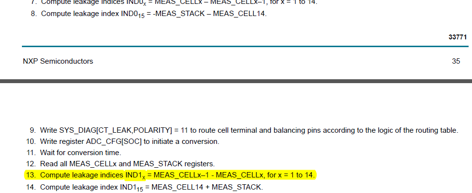

     I have a question about the high-light part of MC33771's datasheet(Page36):
         In the line"13.Compute leakage indices IND1x = MEAS_CELLx–1 - MEAS_CELLx  , for x = 1 to 14." Its says: " x=1to14" ,  so ,when x =1, x-1 = 0, then IND11 = MEAS_CELL0 - MEAS_CELL1.   But ,actually,MC33771A doesn't has the  measurement register  MEAS_CELL0, so I think  may be its a fault of the datasheet, but also may be my misunderstanding of the content. Could you please solve this confuseness for me , I'll appreciate it if I can get your reply.
                Best Regards!
               Huang ziyi

Hello Huang,
It has already been corrected in the latest version of the MC33771A datasheet:
If you want a complete datasheet, please create a standard ticket.
