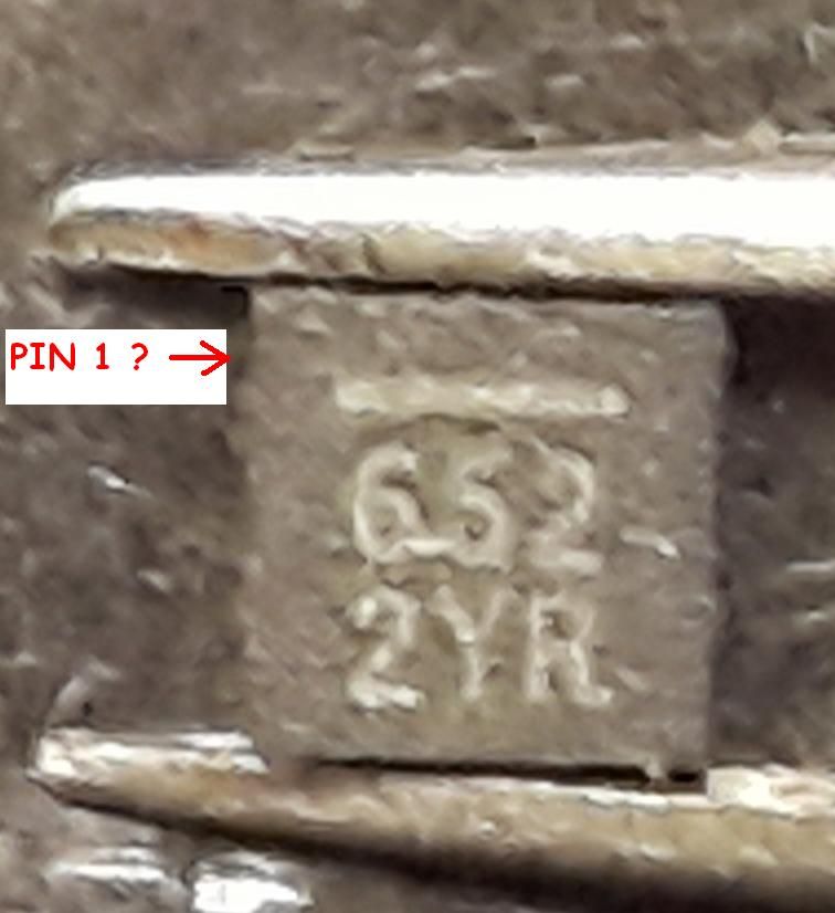

Hi, I would like to be sure about MMA8652 mounting pinout. My sensor has a line and a "652 2YR" marking below.
Looking this, pin 1 is on the top left corner? Please refer to the attached image.
Thanks.

Hi Pedro,
Yes, pin 1 is in the top left corner:

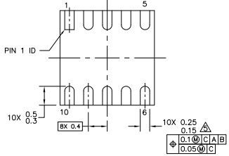

Square pad for pin 1, rounded pad for the other pins:

petrus6432
Thanks Tomas, one less thing to doubt.
