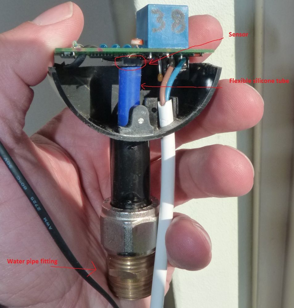

What was the process you followed to add silicon oil to the sensor? did you exposed the entire sensor to vacuum or just the inlet pressure port?
After the silicon oil got out of the sensor, is there any chance that high humidity could reached the inlet pressure port?
It would help us to better understand the problem if you could share some pictures of your hardware.

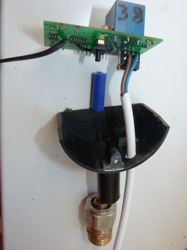

mikedrebby
Hi Josh,
The sensor package was put in a vacuum container during the process of inserting the silicone oil.
The device will be installed vertically , so there is guarantee always will be a trapped air in the pipe(s). The trapped air will eventually get very humid anyway. the distance between the sensor port and the water is between 3 to 12 cm depending on the applied pressure.
I have cut one of the devices to make it clear how it was installed.
I hope this will help a bit making clear how the sensor was installed inside the device.
Mike

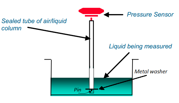

The document you followed (AN3728) has something I would change. Take a look at page two, figure 2 "Media Separated by a column of Clean Dry Air"
http://cache.freescale.com/files/sensors/doc/app_note/AN3728.pdf
The air column should go from the _BOTTOM_ of the tank, up to the pressure sensor, not at the same level of the water or higher as shown in the image. This air column inside the tube would be naturally created, just connect the sensor to the tube while the tank is empty (or before inserting the tube into the water), then when the water goes up, the level of the water will _INCREASE_ the pressure of the air inside the tube.
I would modify the image as follows:
Otherwise, if you insert the tube into the water before connecting the sensor, the water level inside the tube will be the same than tank level, hence, if the water level goes down, the pressure of the air inside the tube would become vacuum.
All of our pressure sensors are designed to be used under P1>P2 condition at any given moment. The MPXM2202GS pressure port #1 (P1) is the only pressure port available, however pressure port #2 (P2) is underneath the device (small hole), hence P2 is always exposed to atmospheric pressure. Therefore, while you apply pressure into P1, you're actually measuring the differential pressure between P1 and atmospheric pressure (gauge pressure type).
If the pressure inside of the tube, goes below atmospheric pressure, P2 would become greater than P1, which would permanently damage the sensor.
Would you please take a look at this and confirm that the "air column" is being created from the bottom of the tank up to the sensor and not from the water level up to the sensor?
Hope it helps.
Josh

Joshevelle
Senior Contributor I
Mike,
In your specific application, the air column is very small, hence high humidity will reach the sensor and eventually the humidity will condensate into the pressure port of the sensor. I would highly recommend you to protect the devices with silicone grease _AND_  change the blue "flexible silicone tube" for a smaller diameter tube and make some loops with it, that way, the high humidity would condensate inside the loops and not in the sensor. Also the silicone grease would be trapped in the loops, protecting the sensor from the high humidity.
Hope it helps.
Josh
