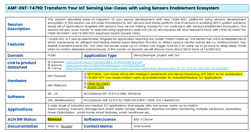

  • Session Overview
  • Session Details

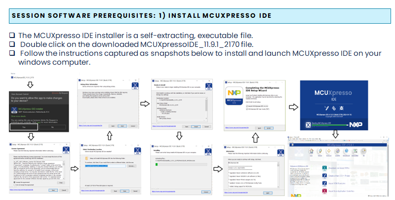

1. MCUXpresso IDE v11.9.0 or newer

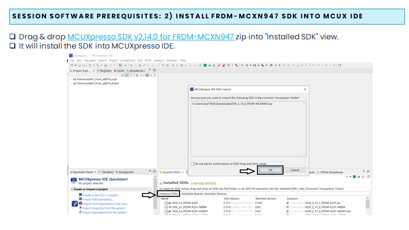

2. MCUXpresso SDK v2.14.0 for FRDM-MCXN947
(while generating SDK select ISSDK and FreeMASTER middleware)

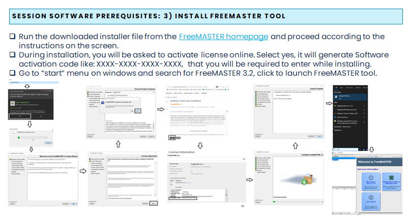

3. FreeMASTER Tool v3.2 or newer: FreeMaster Run-time Debugging tool

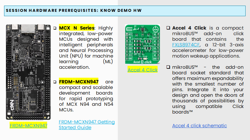

  • HW prerequisites: HW Setup and Connection
 1. Know the HWs for Hands-On Training:
 2. Connect HWs to get ready for Hands-On Session:

Hands-on training material and boards (“FRDM-MCXN947” and “Accel 4 Click” boards) will be provided for training purpose only.
