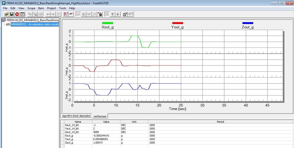

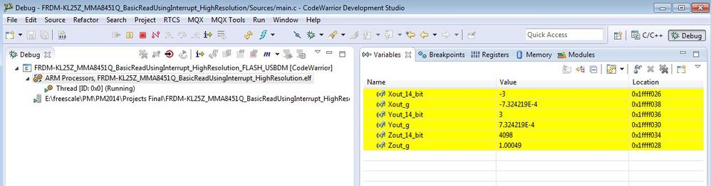

6. The calculated values can be watched in the "Variables" window on the top right of the Debug perspective or in the FreeMASTER application. To view both the 14-bit and real values in the FreeMASTER application, some USBDM drivers need to be first installed on your computer. They are available for download from SourceForge. Erich Styger described their installation in this tutorial. In addition to that, the USBDM_OpenSDA application that provides both debugging and a virtual serial port needs to be loaded into the MK20 debugger chip on the FRDM-KL25Z board. This installation follows the usual FRDM-KL25Z bootloader process:

Attached you can find the complete source code written in the CW for MCU's v10.5 as well as the FreeMASTER project.
