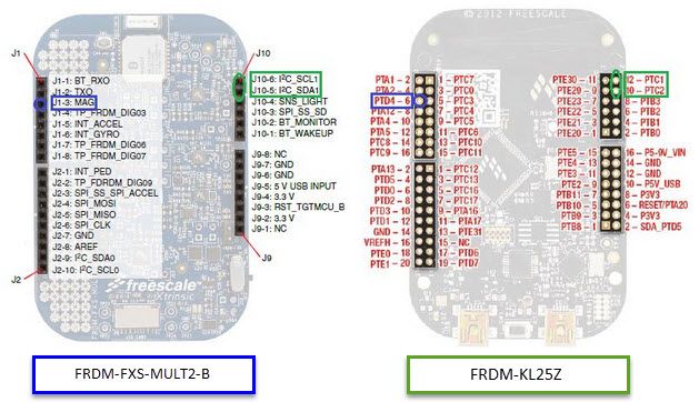

1. Initialization of the MKL25Z128 MCU
Based on the figure below, the SCL and SDA signals, from the I2C Module, are connected to the PTC1 and PTC2 pins respectively. The INT1 output of the MAG3110 is connected to the PTD4 pin of the KL25Z.
Please make sure the 2&3 pins of the J3 are connected together using a jumper at the FRDM-FXS-MULT2-B.
The RGB LED from the FRDM-KL25Z is also set using the PTB18 and PTB19 pins as GPIOs.

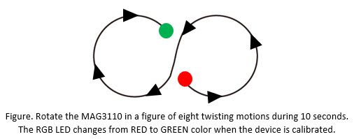

3. Simple magnetic hard-iron offset calibration.
Please note that the magnetometer readings must be corrected for Hard-Iron and Soft-Iron effects. If you are interested in more complex algorithms you may refer to the NXP E-Compass Software.
As an alternative, a method to calibrate the hard iron offset is rotating the MAG3110 in a figure of eight twisting motions for a few seconds, record the minimum and maximum magnetometer readings, compute the corresponding offset values by using the min/max averaging and then either subtract these offset values from the current magnetometer measurements or write them in the user offset registers with CTRL_REG2[RAW] = 0.
The hard iron offset calibration is done as follow:

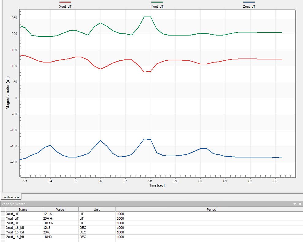

6. FreeMASTER
FreeMASTER is a user-friendly real-time debug monitor and data visualization tool that you can use for any application development and information management. In this case, it is used in order to visualize the magnetic data.
In case you have problems with the communication port, please go to Project / Options…
Select Plug-in Module and choose the FreeMASTER BDM Communication Plug-in option.
Select configure and make sure the P&E Kinetis is selected.
Select OK and Start the communication.
