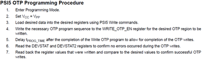

OTP programming 烧写流程

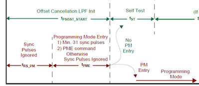

进入烧程模式PME(Programming Mode Entry)的时序
  • 上电后delay(tRS_PM) 6ms
  • 发至少31个同步头,同步头的时间周期必须满足 245-255us
  • PME command
  • 注:上电后6ms+127ms中如果没有收到PME command, 则退出PM Entry.
烧写电压Vpp 电压9-11V是指BUS_I/VCC pin上电压
依据寄存器配置内容,写寄存器,寄存器默认值为0x00,如配置内容是默认值,则不需要写
寄存器配置内容写好后,
0x80到WRITE_OTP_EN($11) 烧写UF0, delay 10ms 烧写完成
0x81到WRITE_OTP_EN($11) 烧写UF1, delay 10ms 烧写完成
0x8E(跳过COMMTYPEPHYSADDR寄存器烧写)到WRITE_OTP_EN($11) 烧写UF2, delay 10ms 烧写完成
验证步骤:
  • 读回烧写过的寄存器,确保烧写内容是否正确
  • DEVSTATDEVSTAT2 寄存器,判断是否在烧写过程中有错误产生。
  • 烧写UF1UF2后,做Margin read, 判断烧写深度是否足够
烧写注意事项:
  • OTP烧写中常出现的问题主要是烧写深度不足。失效现象是通过PSI5总线收到传感器错误代码,10-bit 500 0x1F4, 16-bit 32000 0x7D00(PSI5_CFG寄存器中 EMSG_EXT = 0)10-bit 491 0x1EB, 16-bit 31424 0x7AC0PSI5_CFG寄存器中 EMSG_EXT = 1)错误码可能是会在传感器放置或者工作后一段时间,如几天,几个月或更长时间后产生,所以如发生该问题容易导致客户端失效。目前已知原因是:
  1. 烧写电压VPP不够: DatasheetVpp 电压9-11V是指BUS_I/VCC pin上电压,要考虑串联电阻和线束的压降,确保烧写OTP过程中,BUS_I pin电压稳定在这个范围内
  2. 烧写时间不足,写WRITE_OTP_EN后的延时必须大于10ms, 以保证烧写完成(这里写的OTP Program Timing 最大值10ms是每颗芯片需要烧写的时间有区别,但芯片最大的烧写时间是10ms, 所以烧写时间需要大于10ms以确保每颗芯片都烧写深度足够。)

为确保该问题不发生,请确保前面的两点已经满足,并且推荐烧写UF1UF2后,做Margin read, 判断烧写深度是否足够。并将所有烧写后寄存器读回,判断烧写内容是否正确。
  • 还要注意进入烧写模式(PME)后,请勿热插拔FXLS93xxx 芯片或模块, 以避免芯片损坏。

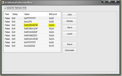

Seskion configuration

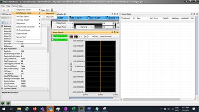

Once the script is generated from the NXP script generator tool you will need to load it on the PSI5 Simulyzer from Seskion by going into Tools-> ECU Pattern Editor -> Channel 0 -> Load -> Select generated script file.
Make sure that “Use for Sensor Init” is ticked , see below snapshot.

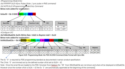

Below an example of a script generated by the Seskion Script generation tool :
The 2 first “0” are trimmed out by the defined number of bit set to 0x2A = 42.
Note : Once the script file are loaded to the PSI5-Simulizer from Seskion the “00” from 00b32ba623e are not shown and what will be displayed is b32ba623e. However since the number of bit is 0x2A = 42 the 5x ‘0’ are automatically appended at the beginning of the command.

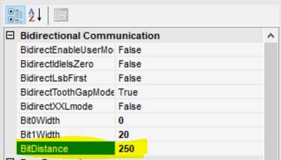

If the programming using the PSI5 Simulyzer from Seskion is not working there few things to consider for debug :
  1. Make Sure that the bit distance in bidirectional communication is set to 250us as specified in sensor product specification.

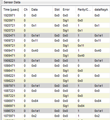

烧写过程,一定是先点RUN, 然后再点Power ,烧写完成后sensor一直发送0x1e1, 就代表烧写成功了
