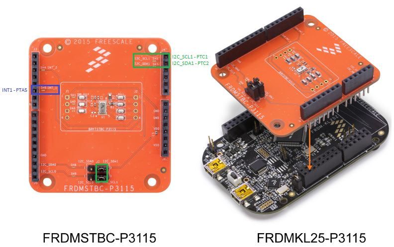

1. As you can see in the FRDMSTBC-P3115 schematic and the image below, with jumpers J7 and J8 in their default position (2-3), the I2C signals are routed to the I2C1 module (PTC1 and PTC2 pins) of the KL25Z MCU. The INT1 output is connected to the PTA5 pin and configured as push-pull active-low output, so the corresponding PTA5 pin configuration is GPIO with an interrupt on falling edge.
The configuration is done in the BOARD_InitPins() function.

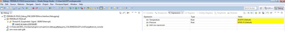

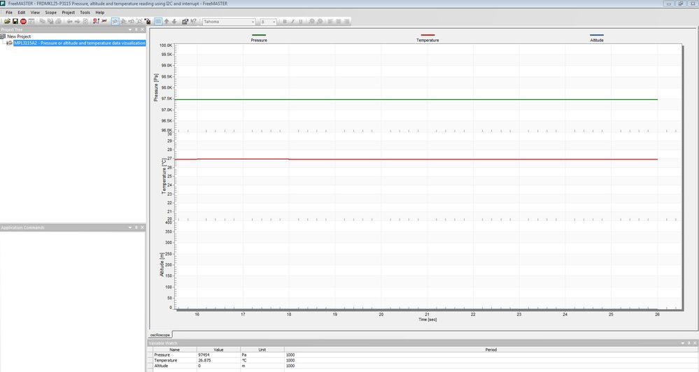

6.  The calculated values can be watched in the Debug perspective or in the FreeMASTER application. To open and run the FreeMASTER project, install the FreeMASTER 2.0 application and FreeMASTER Communication Driver.
Attached you can find the complete source code written in the KDS 3.0.2 including the FreeMASTER project. If there are any questions regarding this simple application, do not hesitate to ask below. Your feedback or suggestions are also welcome.
