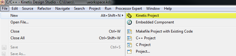

1. Create a new project in KDS
Within KDS, click on "File" menu item and select "New" > "Kinetis Project"

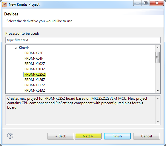

Select the development board used (in my case it is the FRDM-KL25Z) and click Next.

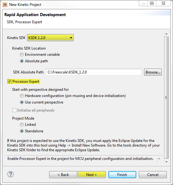

Select “KSDK 1.2.0”. Set location to KSDK path, I use an absolute path. The location of my KSDK is in the default location where KSDK would install to. Ensure “Processor Expert” checkbox is checked. Press Next.

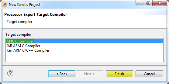

Make sure that “GNU C Compiler” is selected. Click the "Finish" button.

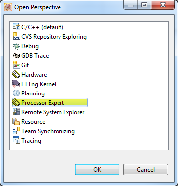

Open the Processor Expert perspective, this should be a button on the top right hand side of Eclipse.
If it is not there, try clicking on the “Open Perspective” button and then selecting “Processor Expert” in the form that appears.

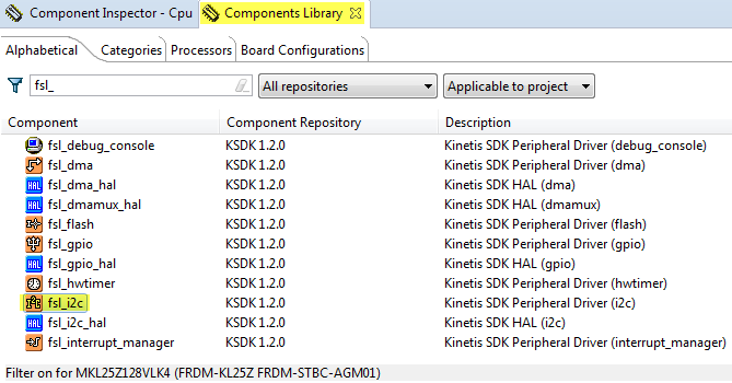

Click on the “Components Library” tab, search for the component “fsl_i2c” and double click on it.

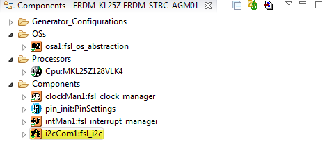

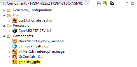

Select the "i2cCom1:fsl_i2c" in the Components window.

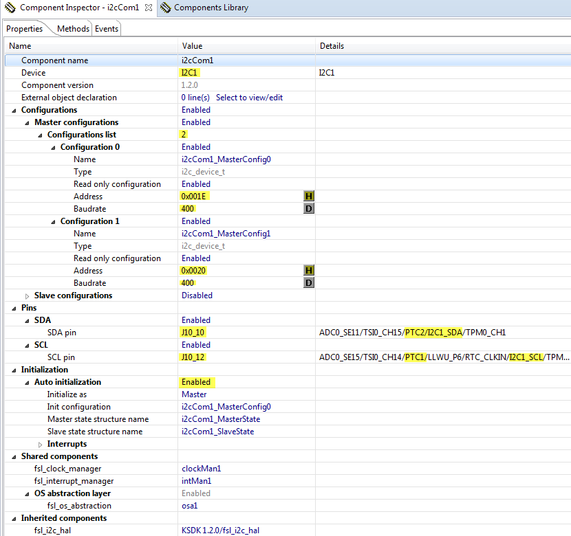

In the "Component Inspector" tab configure the I2C component. As you can see in the FRDM-STBC-AGM01 schematic, with jumpers J6 and J7 in their default position (2-3), the I2C signals are routed to the I2C1 module (PTC1 and PTC2 pins) of the KL25Z MCU. The 7-bit I2C slave address of the FXOS8700CQ is 0x1E (to enter hex values, switch the format to the ‘H’ mode) since both SA0 and SA1 pins are shorted to GND. The address of the FXAS21002C is 0x20 since SA0 pin is also shorted to GND. The I2C bus clock frequency is set to 400 kHz.

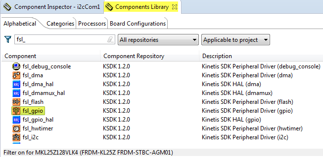

Click on the “Components Library” tab, search for the component “fsl_gpio” and double click on it.
Select the "gpio1:fsl_gpio" in the Components window.

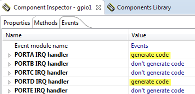

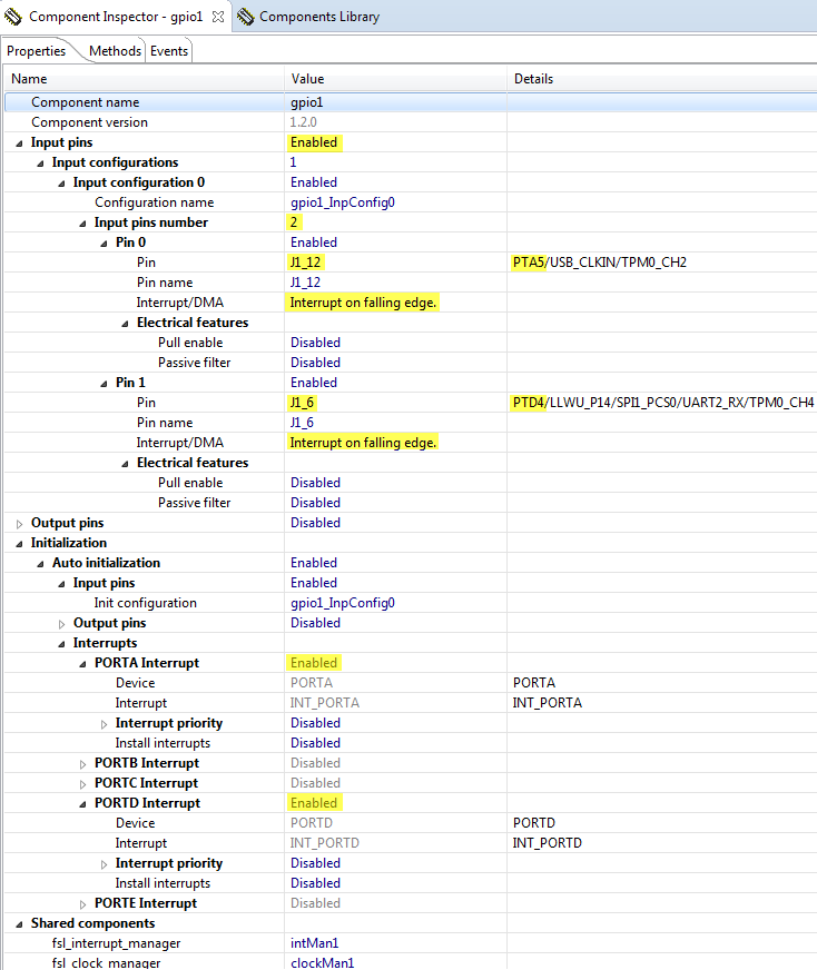

In the "Component Inspector" tab configure the GPIO component. The INT1_8700 output is connected to the PTD4 pin and the INT1_21002 pin to the PTA5 pin of the KL25Z MCU. These both interrupt pins are configured as push-pull active-low outputs, so the corresponding PTD4/PTA5 pin configuration is GPIO with an interrupt on falling edge.
To enable both the PORTA and PORTD interrupts, select the “Events” tab and then select “generate code” next to PORTA IRQ and PORTD IRQ handlers.

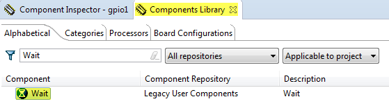

5. Add Wait component​
Click on the “Components Library” tab, search for the component “Wait” and double click on it.

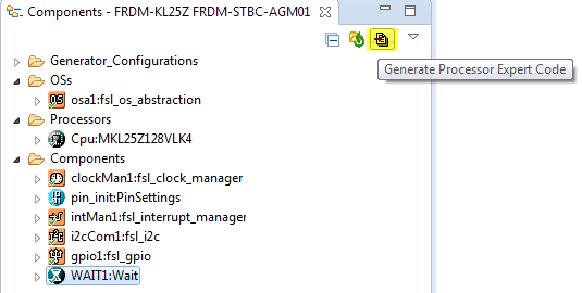

At this point we have done all we can within Processor Expert. Make sure you save all on the project at this point then on the Components window, click on the "Generate code" button.

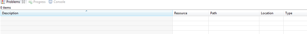

If everything goes well, no errors are shown in the "Problems" view:

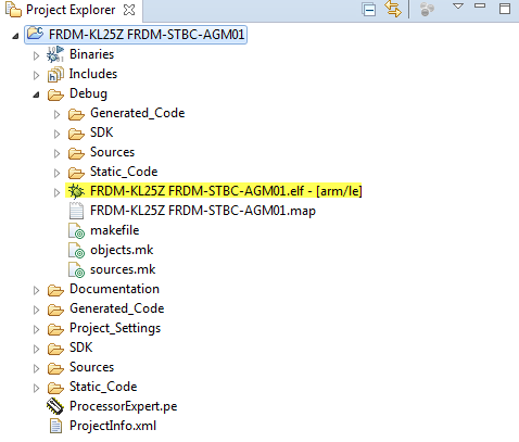

The .elf (binary) file has been created inside the "Debug" folder:

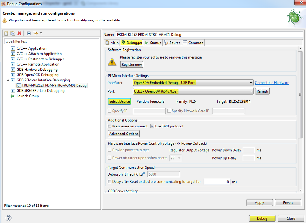

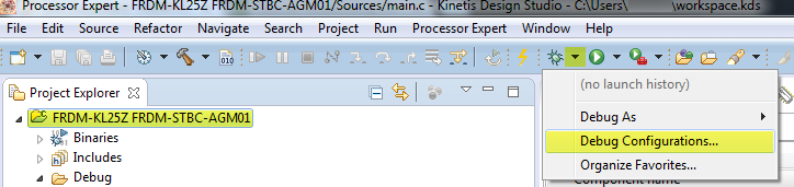

Connect the SDA port on the FRDM-KL25Z board to a USB port on your computer. To debug the project for the first time, select the root folder of the project in the Project Explorer view and open the "Debug Configurations" window.
Select the ""GDB PEMicro Interface Debugging" and click the "New launch configuration" icon.
In the "Debugger" tab, select the "OpenSDA Embedded Debug - USB Port" interface and the KL25Z128M4 as a target device. Click the "Debug" button.

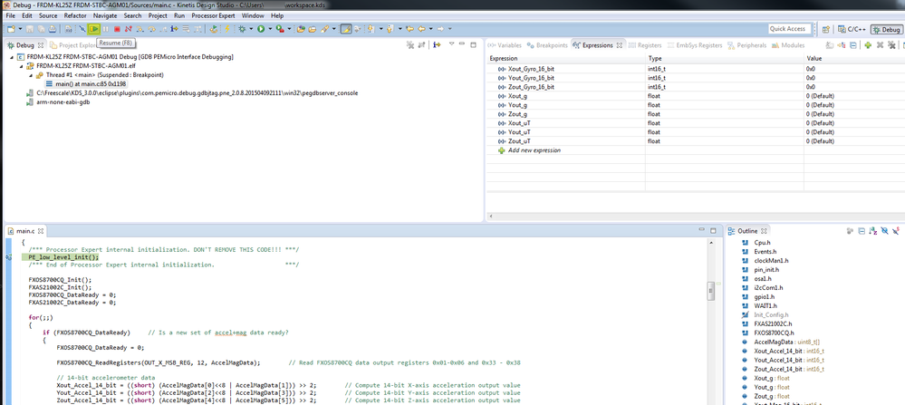

Click the "Resume" button to run the project.

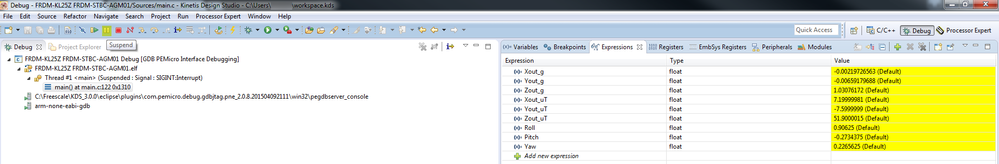

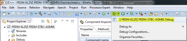

You can pause the execution and look at the data using the "Suspend" button.
Now you can edit, build and debug the project again. As we used a debug configuration, it is listed under the "Debug" icon, so you can start it from there.
