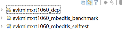

Hi @TomGibson ,
Looks like it is a topic regarding integration of DCP and MbedTLS, and seems they have already been integrated together.
Please kindly refer to the SDK package for more details.
Kan
