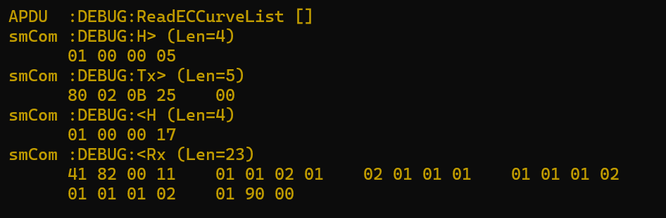

Please find the APDU log details.

Hi @krsuresh ,
Thanks for the info! have you tried the plain communication with SE050C? The log should be something like below:

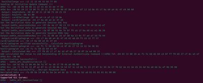

9,949件の閲覧回数
krsuresh
Hi @Kan_Li
Please find the log details attached. I am unsure why the attachment is not displaying on your end, even though I have already included the log information here.
Log Details:
Se05x crypto Example !
Plug and Trust nano package - version: 1.5.4
I2C driver supports plain i2c-level commands.
APDU Tx> :00 a4 04 00 10 a0 00 00 03 96 54 53 00 00 00 01 03 00 00 00 00 00
APDU Rx< :03 01 00 6f ff 01 0b 90 00
Establish Secure Channel to SE05x !
hostChallenge ==> :11 22 33 44 55 66 77 88
Sending GP Initialize Update Command !!!
APDU Tx> :80 50 0b 00 08 11 22 33 44 55 66 77 88
APDU Rx< :90 03 92 84 04 50 05 99 37 34 0b 03 00 49 87 9e 91 c8 8e a5 05 4e c7 68 e0 01 db cd fb 90 00
Output: keyDivData :90 03 92 84 04 50 05 99 37 34
Output: keyInfo :0b 03 00
Output: cardChallenge :49 87 9e 91 c8 8e a5 05
Output: cardCryptoGram :4e c7 68 e0 01 db cd fb
Set the Derviation data to generate Session ENC key
Output:scp03_session_enc_Key ==> :3b aa cc 97 b6 9a c8 67 81 1c 43 da 4b c8 50 ac
Set the Derviation data to generate Session MAC key
Output:scp03_session_mac_Key ==> :50 aa 3d e2 bd 41 13 f8 4f 99 4c e1 24 08 65 3d
Set the Derviation data to generate Session RMAC key
Output:scp03_session_rmac_Key ==> :b4 ab 4b 42 1a b5 47 8f 0e e9 47 36 9d 52 a1 8c
Output:cardCryptogram ==> :4e c7 68 e0 01 db cd fb fb 61 21 7c aa 3b c8 fd
cardCryptoGram ==> :4e c7 68 e0 01 db cd fb

APDU - Se05x_API_ReadECCurveList []
SCP03: Encrypted Data ==> :84 02 0b 25 08 e3 fc c6 50 cd 1b 88 50
APDU Tx> :84 02 0b 25 08 e3 fc c6 50 cd 1b 88 50
APDU Rx< :55 49 93 04 25 48 e5 02 b4 45 9a 75 98 40 2c a7 bd 22 8c 24 62 23 33 12 f8 a1 52 93 5b c4 34 32 19 f2 3c 1e e5 a8 82 a4 90 00
SCP03: RMAC verified successfully...Decrypt Response Data
SCP03: Decrypted Data ==> :41 82 00 11 01 01 02 02 02 01 02 01 01 01 01 01 01 01 01 02 01 90 00
curveID = 4 already exists
