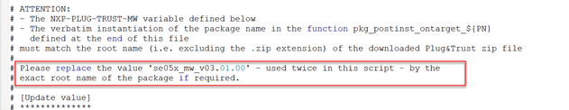

Hi @APridy ,
Actually the recipe is similar across different versions, what you have to do is updating the part indicating the version info.  Please kindly refer to the recipe file or the following for details.
Kan
6,724 Views
APridy
Hi @Kan_Li ,

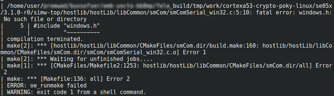

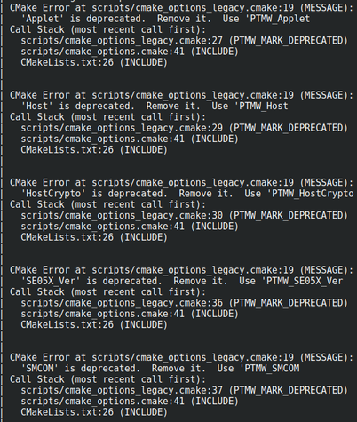

Before starting this topic, i have already changed se05x_mw_v03.01.00 to actual version, but recipe still generated a bunch of errors.
Below are error messages that i received while trying to make this recipe work:
(in chronological order)
1) Parsing error
Fixed by changing do_install_append -> do_install:append
2) Parsing error
Fixed by removing "python" from DEPENDS (python3 remains)
3) do_configure error
Fixed by adding PTMW to listed cmake arguments
4) do_compile error
Fixed by removing all instances of -Wformat_security from original middleware archive
(this was suggested to someone with similar problem on nxp forum)
5) do_compile error
Here for some reason it tried to compile source code for windows machines (despite -DHost=iMXLinux in cmake call).
At this moment i decided that something is seriously wrong with this recipe and went to nxp forums, where i found mentions of newer se05x_04.01.03.bb file (see my original post).
First three errors occured because of deprecated syntax, and fourth because of latest version of gcc (something changed about -Wformat_security).
