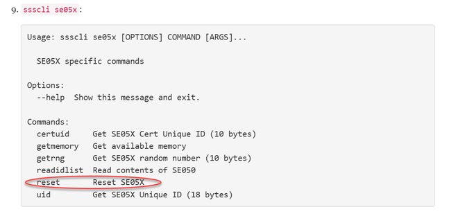

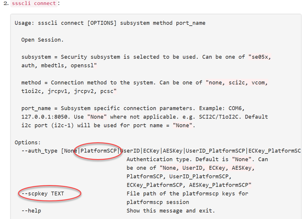

Hi @kennychiu ,
I think the SE on your hands might be provisioned with some secure objects already, which consumed the memory inside, so please try to run the se05x_Delete_and_test_provision demo out of the full version of MW , or using the ssscli tool to reset the SE to a known state with the following command:
BTW, ssscli tool also supports readidlist, if you enabled PlatformSCP already, you have to specify the keys in a text file for authentication before connection. Please kindly refer to the following for more details.
Hope that helps,
Kan
