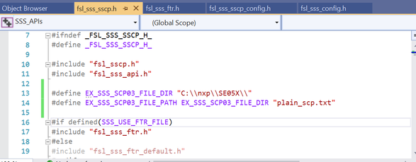

They are set in file by the environment variable, by command:
EX_SSS_BOOT_SCP03_PATH=/home/root/plain_scp.txt openssl engine

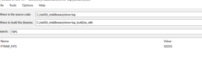

You may also switch on FIPS option to make the MW built for the SE050F IoT Applet which is version 3.6.
of course it is not the root cause, but makes sense. It just slightly modifies the behavior of some examples.

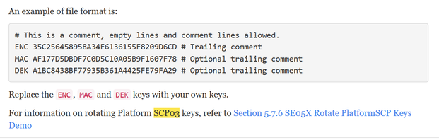

If yes, Did you change the SCP03 keys? Because our default keys are:
Please kindly refer to simw-top/doc/appendix/platfscp.html?highlight=scp03 for more details.
Kan

No, I'm using exactly this keys:
ENC 35C256458958A34F6136155F8209D6CD
MAC AF177D5DBDF7C0D5C10A05B9F1607F78
DEK A1BC8438BF77935B361A4425FE79FA29
Thanks.

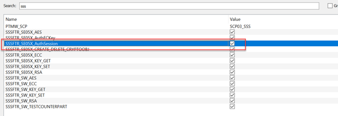

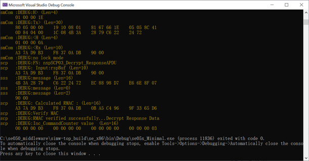

Kan_Li
Hi @ElielderBMelo ,
Since the dev kit still holds the default keys, so it should work with any demo code with Applet SCP03 Authentication enabled. Did you try it from your side?

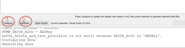

To do this, you have to run cmake-gui . to enter the configuration view for cmake, and change the following options.
then configure and generate
and run cmake --build .
if you meet the following issue when running any demo,
please execute se05x_Delete_and_test_provision.exe at first to provision the Authentication Key.
With the default SCP03 keys, you may run any demo starting with an Applet SCP03 authentication like below.
If you run the demo following above steps, it means the dev kit on your hands should be ok, we should focus on the host application instead.
Hope that makes sense,
Kan

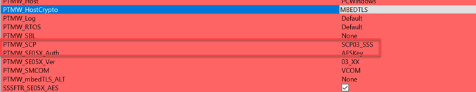

Hi, Kan Li.
I'm not working in Windows, I'm working in Embedded Linux and I took the .bin in MCU folder in "simw-top/binaries/MCU/" and no one of them worked in my environment.
Attached to this message there is my C-Make configuration file. My environment configuration are shown there.
For your knowledge:
- I'm building a cross compiled library to work with OpenSSL.
- My library are attached to OpenSSL by the "openssl.cnf" file.
- The command that I'm testing is a simple engine operation, only to connect to the device by "openssl engine -t".
- This command above are working with no SCP03 Authentication, but when SCP03 is required it doesn't work well.
- I enabled the SCP03 by following manual and instructions there.
- And I don't what to do for that values of "cardCryptogram" to match between each other

Kan_Li
Hi @ElielderBMelo ,
Thanks for the information! Looks like you are using platform SCP03 authentication instead of AESKey, so I changed my configuration as yours.
and use external file containing the platform SCP03 keys.
The authentication passed successfully with the following keys.
ENC 35C256458958A34F6136155F8209D6CD # Trailing comment
MAC AF177D5DBDF7C0D5C10A05B9F1607F78 # Optional trailing comment
DEK A1BC8438BF77935B361A4425FE79FA29 # Optional trailing comment
but if I use a different MAC key , for example,
MAC AF177D5DBDF7C0D5C10A05B9F1607F72
The authentication failed as similar as you met.

Please kindly check the keys setting from your side, both the embedded Linux host and the SE050 dev kits. You may run the demo of "Delete and Test Provision" as I mentioned before to inject the default the authentication objects into the dev kits.
Hope that helps,

Kan_Li
Hi @ElielderBMelo ,
Thanks for the information! I checked the cmake option from your side, almost the same, except the host.
I am wondering with which configuration you run the demo of "Delete and Test Provision"?
-DSCP=SCP03_SSS
-DSE05X_Auth=PlatfSCP03
Or
-DSCP=None
-DSE05X_Auth=None
As you mentioned before, the GetInfo demo can run well without SCP03 Authentication, so I think it should be the same the demo of "Delete and Test Provision", right? Please kindly clarify.
Kan

Kan_Li
Hi @ElielderBMelo ,
Thanks for the information! I have just checked with the expert, from the ATR info, looks like SE050F2 is on your board, and it uses different SCP03 keys as the default ones on the dev kits.
Please use the above keys instead and check if they make any difference. Please refer to https://www.nxp.com/docs/en/application-note/AN12436.pdf for more details.
