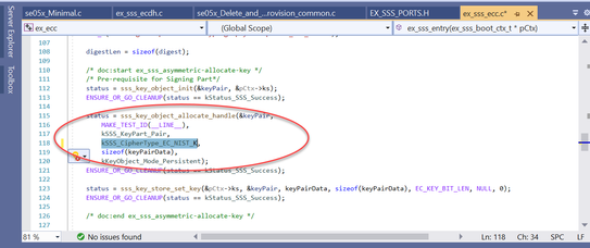

Please kindly check whether Secp256k1 Curve is setup already and ECCurve Parameters are provided, otherwise you have to create it at first. Please also note creating ECCurve by SSS APIs will automatically create the ECCurve with the built-in ECCurve parameters, you may test it with the demo of ex_ecc, by changing kSSS_CipherType_EC_NIST_P to kSSS_CipherType_EC_NIST_K.
Hope that helps,
Kan
