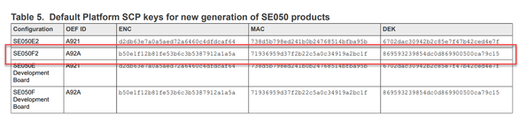

Have you changed the default platform SCP keys? If the OEF ID for your SE050F2HQ1 is right A92A, which can be verified with the help of se05x_GetInfo demo, you may check the key value in
/home/root/se050E_scp_keys.txt
with the following:
Please kindly refer to https://www.nxp.com/docs/en/application-note/AN12436.pdf for more details.
The "SCP key define" instruction in ch.7.2 of 'AN13027.pdf' is for SE050E2 indeed.

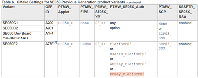

Since you are using SE050F2 now, the cmake option of PTMW_Applet has to be adopted properly, please kindly refer to the following for details.
Please kindly refer to https://www.nxp.com.cn/docs/en/application-note/AN13027.pdf for more details.
Hope that helps,

For SE050C2HQ1
The cmake option is below:
EXTRA_OECMAKE += "\
    -DCMAKE_BUILD_TYPE=Debug \
    -DPTMW_SE05X_Ver=03_XX \
    -DPTMW_Applet=SE05X_C \
    -DPTMW_Host=iMXLinux \
    -DPTMW_HostCrypto=OPENSSL \
    -DPTMW_SMCOM=T1oI2C \
    -DPTMW_FIPS=None \
    -DPTMW_SCP=None \
    -DSSSFTR_SE05X_RSA=1 \
    -DPTMW_SE05X_Auth=None \
get error of :
 warning: 'EC_KEY_****' is deprecated: Since OpenSSL 3.0 [-Wdeprecated-declarations]
need to set -DSS'SFTR_SE05X_RSA=0' which is not the same as table6.
But result is pass:
$ EX_SSS_BOOT_SSS_PORT=/dev/i2c-1:0x48 ./se05x_Minimal
App   :INFO :PlugAndTrust_v04.02.00_20220524
App   :INFO :Running ./se05x_Minimal
App   :INFO :Using PortName='/dev/i2c-1:0x48' (ENV: EX_SSS_BOOT_SSS_PORT=/dev/i2c-1:0x48)
sss   :INFO :atr (Len=35)
      00 A0 00 00    03 96 04 03    E8 00 FE 02    0B 03 E8 08
      01 00 00 00    00 64 00 00    0A 4A 43 4F    50 34 20 41
      54 50 4F
sss   :WARN :Communication channel is Plain.
sss   :WARN :!!!Not recommended for production use.!!!
App   :INFO :mem=32196
App   :INFO :se05x_Minimal Example Success !!!...
App   :INFO :ex_sss Finished
For SE050F2HQ1:
cmake option:
EXTRA_OECMAKE += "\
    -DPTMW_FIPS=SE050 \
    -DPTMW_SCP=SCP03_SSS \
    -DSSSFTR_SE05X_RSA=0 \
    -DPTMW_SE05X_Auth=PlatfSCP03 \
(p.s. '-DSSSFTR_SE05X_RSA=0' because of the compile warning above.)
The result is failed:
$ EX_SSS_BOOT_SSS_PORT=/dev/i2c-1:0x48 /run/media/sda1/se05x_Minimal
App   :INFO :Running /run/media/sda1/se05x_Minimal
App   :INFO :Using default PlatfSCP03 keys. You can use keys from file using ENV=EX_SSS_BOOT_SCP03_PATH
      54 50 4F
scp   :WARN :nxEnsure:'status == kStatus_SSS_Success' failed. At Line:144 Function:nxScp03_AuthenticateChannel
sss   :ERROR:Could not set SCP03 Secure Channel
App   :ERROR:sss_session_open failed
App   :ERROR:ex_sss_session_open Failed
App   :ERROR:!ERROR! ret != 0.
But the error listed below is gone:
sss   :WARN :nxEnsure:'ret == SM_OK' failed. At Line:6971 Function:sss_se05x_TXn
App   :ERROR:Se05x_API_GetFreeMemory Failed

But i encounter some new error on SE050F2HQ1:
root@hmi-imx8mp:~# EX_SSS_BOOT_SSS_PORT=/dev/i2c-1:0x48 /run/media/sda1/se05x_Minimal
App   :INFO :PlugAndTrust_v04.03.00_20221122
App   :WARN :Using SCP03 keys from:'/home/root/se050E_scp_keys.txt' (ENV=EX_SSS_BOOT_SCP03_PATH)
      54 50 4F

 I do follow the "SCP key define" instruction in ch.7.2 of 'AN13027.pdf'.
Here is my cmake option:
SRC_URI = "file://SE05x-MW-v04.03.00.zip \
        file://0001-not-support-Wformat-security-without-Wformat.patch \
        file://se050E_scp_keys.txt \
export EX_SSS_BOOT_SCP03_PATH
EX_SSS_BOOT_SCP03_PATH = "${WORKDIR}/se050E_scp_keys.txt"
EXTRA_OECMAKE += "\
    -DPTMW_OpenSSL=3_0 \
    -DPTMW_FIPS=SE050 \
    -DSSS_PFSCP_ENABLE_SE050F2_0001A92A=1 \
p.s. the 'se050E_scp_keys.txt' is the same as in ch7.2.2.

Kan_Li
Hi @yoooh8668 ,
with the following:
Hope that helps,

I sum up the solution:
For SE050F2HQ1:
1. cmake option
EXTRA_OECMAKE += "\
    -DPTMW_FIPS=SE050 \
Follow the "6 Product specific CMake build settings" in
"https://www.nxp.com.cn/docs/en/application-note/AN13027.pdf"
2. Add Platform SCP Key in test device
# cat /home/root/se050E_scp_keys.txt
ENC b50e1f12b81fe53b6c3b5387912a1a5a
MAC 71936959d37f2b22c5a0c34919a2bc1f
DEK 869593239854dc0d869900500ca79c15
# export EX_SSS_BOOT_SCP03_PATH=/home/root/se050E_scp_keys.txt
Follow the "3.4 Common keys" in
"https://www.nxp.com/docs/en/application-note/AN12436.pdf"
